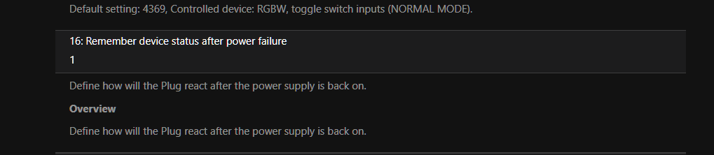

With regards to parameter settings, yes Param 16 is set to 1. Unfortunately Fibaro RGBW controller frequently looses the previous state anyhow…
