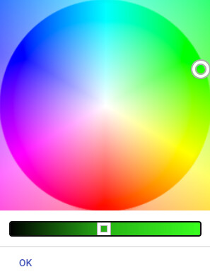

Hi, I have a problem with using the color picker with the Fibaro RGWB 2.
Setting the color and turning it off or on is actually working, but the state of the device seems to be wrong.
Turning on makes following log:
08:02:43.292 [INFO ] [arthome.event.ItemStatePredictedEvent] - GF_MasterBedroom_Light_Bed predicted to become ON
08:02:43.309 [INFO ] [smarthome.event.ItemStateChangedEvent] - GF_MasterBedroom_Light_Bed changed from 223,77,89 to 223,77,100
08:02:44.944 [INFO ] [smarthome.event.ItemStateChangedEvent] - GF_MasterBedroom_Light_Bed changed from 223,77,100 to 223,77,45
08:02:45.744 [INFO ] [smarthome.event.ItemStateChangedEvent] - GF_MasterBedroom_Light_Bed changed from 223,77,45 to 223,77,89

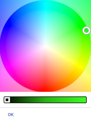

Turning off makes following log:
08:03:22.740 [INFO ] [smarthome.event.ItemStateChangedEvent] - GF_MasterBedroom_Light_Bed changed from 223,77,89 to 223,77,0
08:03:24.328 [INFO ] [home.event.GroupItemStateChangedEvent] - gLight changed from OFF to ON through gLightGF_MasterBedroom
08:03:24.336 [INFO ] [home.event.GroupItemStateChangedEvent] - gLightGF_MasterBedroom changed from OFF to ON through GF_MasterBedroom_Light_Bed
08:03:24.345 [INFO ] [smarthome.event.ItemStateChangedEvent] - GF_MasterBedroom_Light_Bed changed from 223,77,0 to 223,77,54
08:03:25.076 [INFO ] [smarthome.event.ItemStateChangedEvent] - GF_MasterBedroom_Light_Bed changed from 223,77,54 to 223,77,89
The light of the LED is off, but the state in openhab is on.
