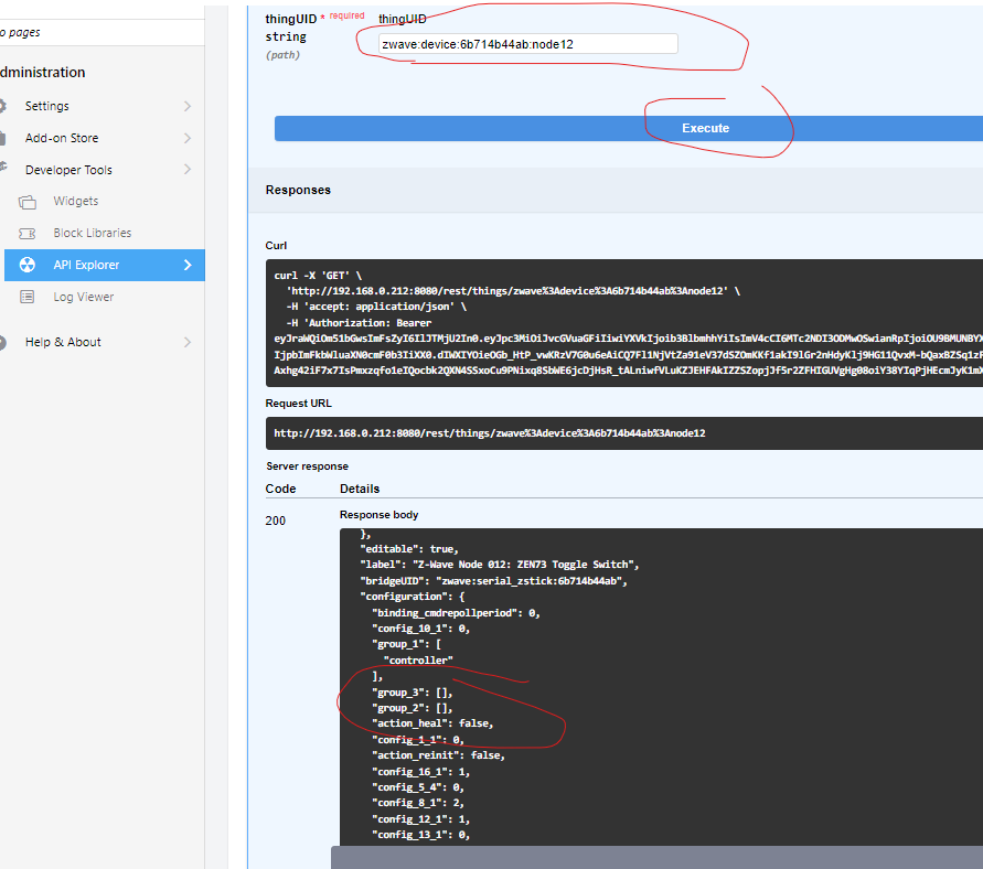

So there is no little > at the end that pops ups with a node list? Could try another browser or worse case use the REST api to modify the configuration (pattern after node with an association)

Don’t know if you tried the API, but here is an example of the “GET”. Make the change and use the “PUT”
I’ve never used the API Explorer before. However, based on your example, I displayed the thingUID of the Fibaro FGS-214 (zwave:device:Razberry2:node046). Everything looks fine to me.
Then, as a test, I also checked the ID 228, which was previously assigned during the openHAB include. – Response: Error: response status is 404.
The idea was to use the API to add (PUT) a node to group 2 following an example from another device.
