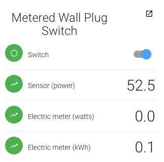

Last week I added a Fibaro Wall Plug to my openhab setup. First only the switch function works, after removing and adding it again now the power value (sensor_power) is shown. But the values for meter_watts and meter_kwh are still empty, even as the Power and energy periodic reports is set to 3600 (default). Any advice what is maybe configured wrong?

but the meter_watts is still 0.

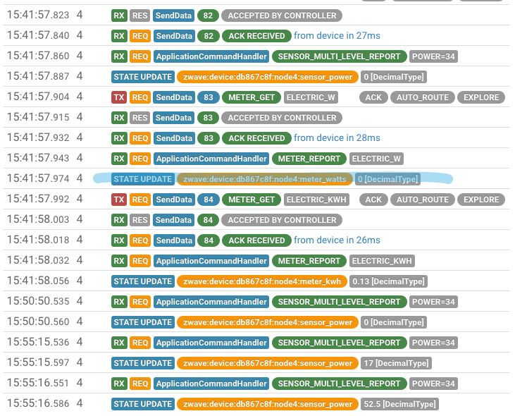

I followed your advice and debugged, seems as the plug is reporting the meter_watts_value, too - but it is still 0.

Just to make sure: My expection for the meter_watts value would be a upcounting value of the power value, right?

Tried it with an electric kettle, but still the reported value is 0:

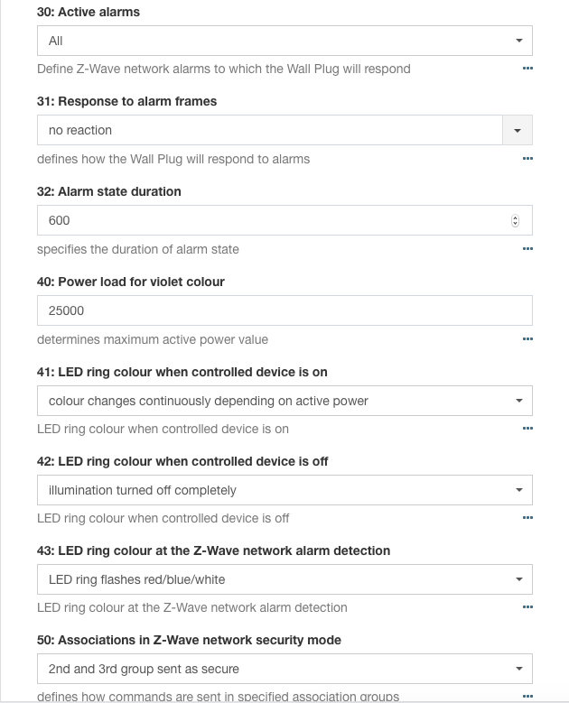

I would check the config settings if anything is suspicious …in any case, check parameter 10, 11, 13, 14.

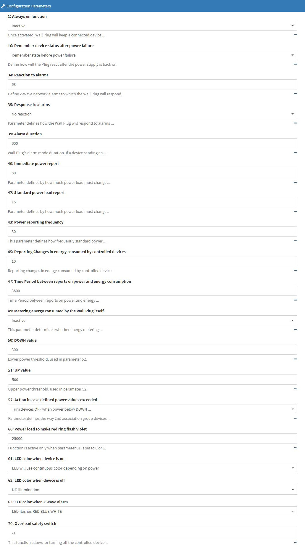

Maybe the config of a working 101 could help a bit:
Hm compared the values with the ones of my 102, seems to be similar, but they have a lot of different parameters:

Yeah, that is a problem when comparing older and newer versions of a device.
Did you configure your wall plug via text files? If yes I would try using HABmin and the graphical config.
I successfully solved a problem that way with my fibaro rollershutter controllers a while back …
