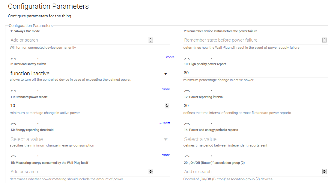

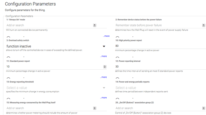

I got Updates same moment. Because I don’t remember the screenshot of power meter parameters of V3.2 device:
Thanks. My settings are very similar, except I cannot get param 13 and 14 to “select a value”, they display a default value (10 and 3600) which cannot be deleted (I think this is a display thing and they are actually empty, you probably have a slightly different version of openHAB). I tried a lot of things, like rebooting the server, excluded the device from the controller, reset and re-include, reconnected the Item. No change. If I stop openhab and start Indigo, I get all the events I expect. Can you tell me which channel you connected the Item to, and maybe show the Item configuration? I think I got this right, because the poll updates the right Item, but maybe I did something wrong there?
