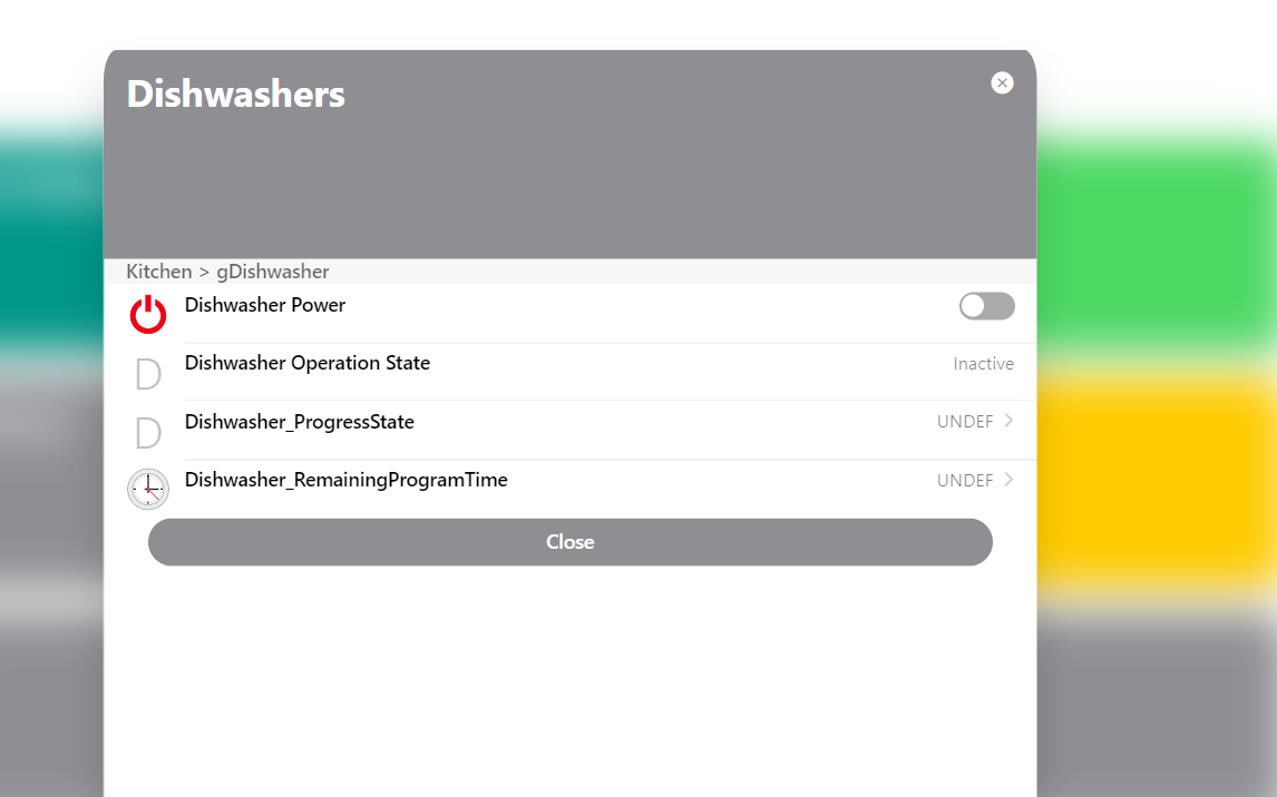

I have a couple of Siemens devices connected via the Home-Connect binding. As soon as you turn the device off, a bunch of items return to the ‘UNDEF’ status. As far as I can tell, this is expected behavior.
But not really a nice sight in the UI..

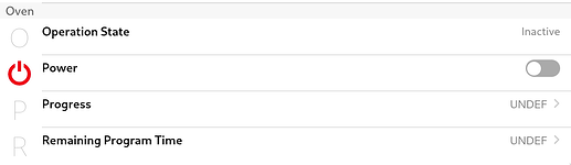

I was looking at Equipment tab, but the issue was everywhere.

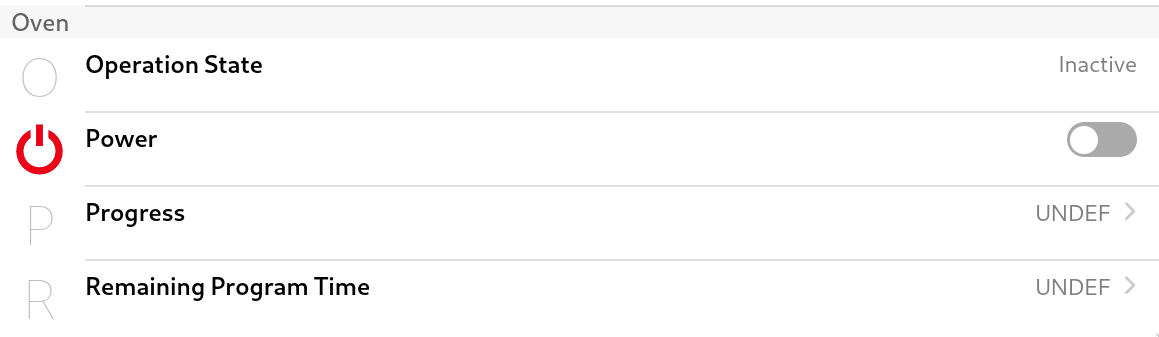

When I look at location tab on overview page it shows
Even when It had some value, stateDescription did not work and I spotted something wired related to default profile in F12 Developers tool, I had to delete this item and re-create it.

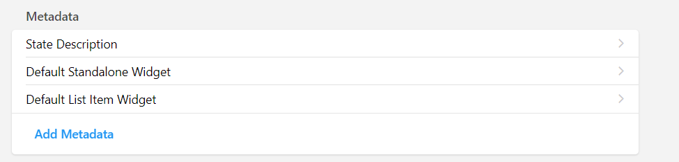

then I added these metadata

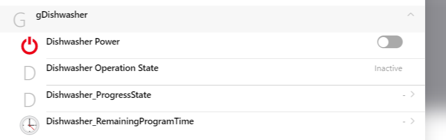

I define value to be shown like
=items.Dishwasher_RemainingProgramTime.state ==="UNDEF"?"-":items.Dishwasher_RemainingProgramTime.state
Now I got this:
So this is what I wanted.
