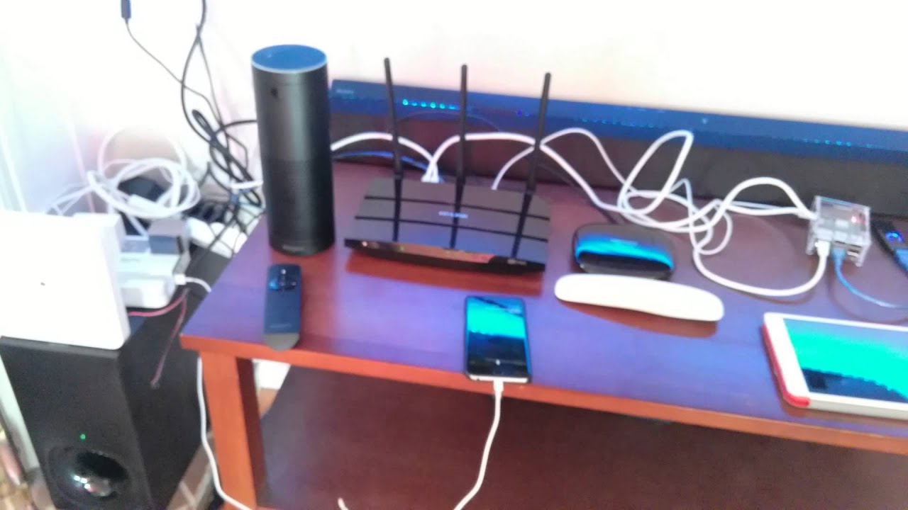

Anyways, I have the same problem. However, I’m using Alexa/Amazon Echo to trigger the Find my iPhone feature. “Alexa, turn on Q’s iPhone”.
Check out my demo here:
