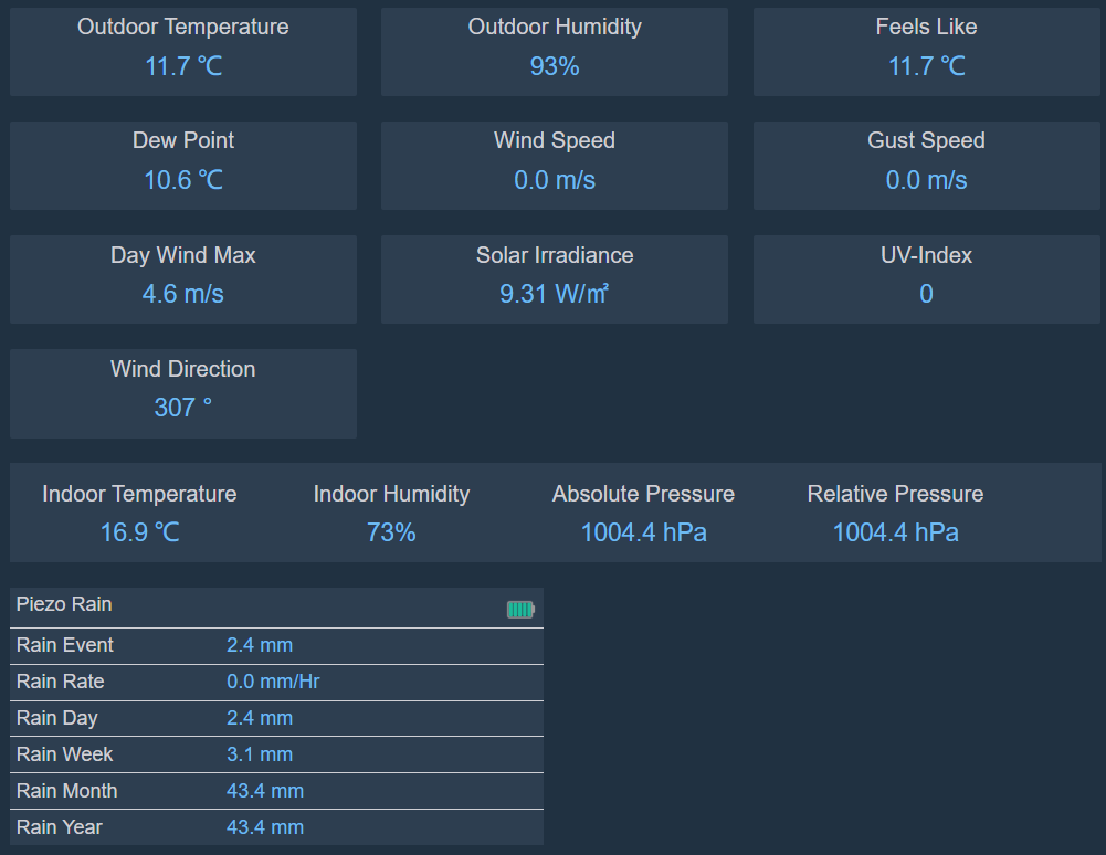

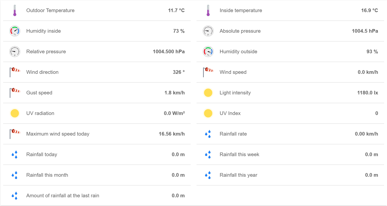

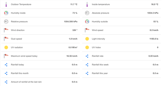

I have the Wittboy with the WH90 sensor.
Everything works nice and it was integrated in OH 4 within a few minutes.
But unfortunately all the piezo-rain-… items are 0,0 … all other values are working fine.
I saw above that this was an issue and has been solved … so am I the only one with this issue? What can I do?
