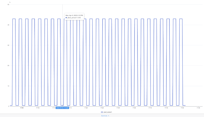

I didn’t know about logs before, but here is what i found. There are hundereds of those entries, but they are just repeating, so I chose an example each. Interestingly the event.log never sees any decimal values. Does that help?
openhab.log
2023-04-03 18:05:01.206 [WARN ] [.core.thing.binding.BaseThingHandler] - Handler BridgeHandler tried updating the thing status although the handler was already disposed.
2023-04-02 21:38:15.720 [WARN ] [le.handler.ItemStateConditionHandler] - Received a QuantityType state ‘46 %’ with unit for item plant_sensor1, but the condition is defined as a plain number without unit (10), please consider adding a unit to the condition.
event.log
2023-04-03 08:06:39.036 [INFO ] [openhab.event.ItemStateChangedEvent ] - Item ‘plant_sensor1’ changed from 46 % to 47 %

jtstreamer:
this looks like you defined the plant_sensor1 item with type Number instead of Number:Dimensionless
as long you are seeing here not values like 0.46 the binding is reporting correct values.
It’s number:diemensionless . I created the item directly from the channel and used all default values.
So this might be an issue of the openhab analyse display?
I just realized that the channel link of the item seems to toggle on and off permanently:
Sometimes I see this:
A few moments later this and then back again:
This seems to correllate with the wrong value in the graph.

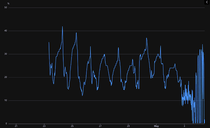

jtstreamer:
There is some buggy behavoiur I’d like to report. As you can see in the screenshot my reported value alternates between 43% and 0.43. I’m not sure what the exact cause of this is, but it should be easy to fix.
I use a ecowitt gw2000 with the soil sensor. For openhab I have a standard installation on a raspberry pi 3.
For now all my rules just ignore everything between 0 and 1% to avoid issues. Hope this feedback is helpful for the project.
I’m experiencing the same thing
I have an Ecowitt GW1100 gateway and WH51 Soil Moisture Sensor
This is my behavior also

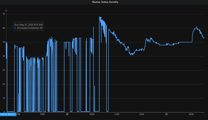

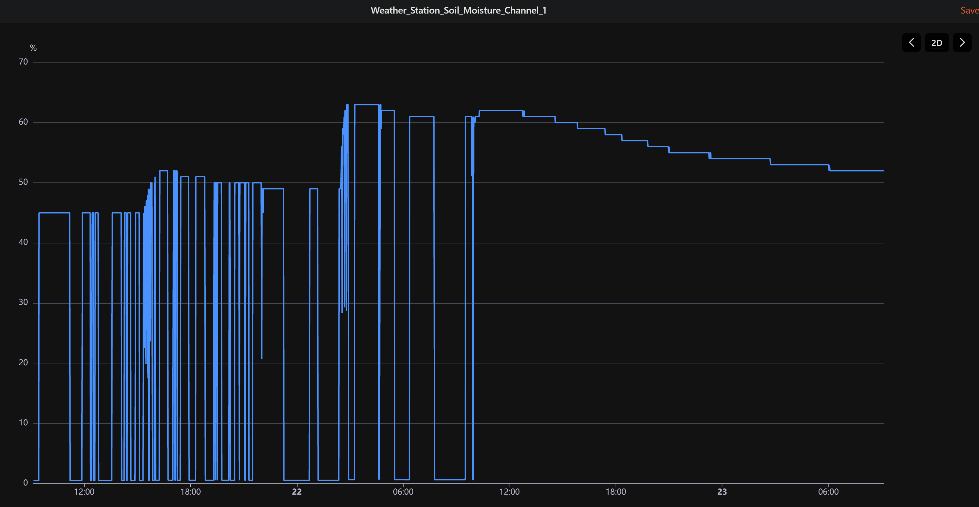

Adi.Corrales
(Adi Corrales Magallanes)
May 4, 2023, 4:54pm
210
Same behavior for me on Ubuntu, but it started as soon as I add the soil sensor and even with the ambient humidity. This is the graph of the GW1000 attached tri-sensor. You can see exactly when I paired the soil moisture sensor and started to oscillate between xx% and 0.xx values.

I need a set of “CMD_GW1000_LIVEDATA” outputs for the time when the unit change / zeroing occurs.
Adi.Corrales
May 8, 2023, 7:41pm
212
I hope this is what you need…
This log is from a period where the tri-sensor goes form % to 0.x although the soil moisture sensor kept the value on %.
These are the changes the sensor registered.

So these are the parsed values from your data:
temperature-indoor
humidity-indoor
pressure-absolute
pressure-relative
moisture-soil-channel-1
26.9 °C
34 %
809.9 hPa
809.9 hPa
24 %
26.9 °C
34 %
809.9 hPa
809.9 hPa
24 %
26.8 °C
34 %
809.9 hPa
809.9 hPa
24 %
26.8 °C
34 %
809.9 hPa
809.9 hPa
24 %
26.8 °C
34 %
809.9 hPa
809.9 hPa
24 %
26.8 °C
34 %
809.9 hPa
809.9 hPa
24 %
26.8 °C
35 %
810 hPa
810 hPa
24 %
26.8 °C
35 %
810 hPa
810 hPa
24 %
26.8 °C
35 %
810 hPa
810 hPa
24 %
26.8 °C
35 %
810 hPa
810 hPa
24 %
26.8 °C
35 %
809.9 hPa
809.9 hPa
24 %
26.8 °C
35 %
809.9 hPa
809.9 hPa
24 %
26.8 °C
35 %
809.9 hPa
809.9 hPa
24 %
26.8 °C
35 %
809.9 hPa
809.9 hPa
24 %
26.8 °C
35 %
810 hPa
810 hPa
24 %
26.8 °C
35 %
810 hPa
810 hPa
24 %
26.8 °C
35 %
810 hPa
810 hPa
24 %
26.8 °C
35 %
810 hPa
810 hPa
24 %
26.8 °C
35 %
810.1 hPa
810.1 hPa
24 %
26.8 °C
35 %
810.1 hPa
810.1 hPa
24 %
26.8 °C
35 %
810.1 hPa
810.1 hPa
24 %
26.8 °C
35 %
810.1 hPa
810.1 hPa
24 %
26.8 °C
34 %
809.9 hPa
809.9 hPa
24 %
26.8 °C
34 %
809.9 hPa
809.9 hPa
24 %
26.8 °C
34 %
809.9 hPa
809.9 hPa
24 %
26.8 °C
34 %
809.9 hPa
809.9 hPa
24 %
26.9 °C
34 %
809.9 hPa
809.9 hPa
24 %
26.9 °C
34 %
809.9 hPa
809.9 hPa
24 %
26.9 °C
34 %
809.9 hPa
809.9 hPa
24 %
26.8 °C
34 %
809.8 hPa
809.8 hPa
24 %
26.8 °C
34 %
809.8 hPa
809.8 hPa
24 %
26.8 °C
34 %
809.8 hPa
809.8 hPa
24 %
26.8 °C
34 %
809.8 hPa
809.8 hPa
24 %
26.8 °C
35 %
809.8 hPa
809.8 hPa
24 %
26.8 °C
35 %
809.8 hPa
809.8 hPa
24 %
26.8 °C
35 %
809.8 hPa
809.8 hPa
24 %
26.8 °C
35 %
809.8 hPa
809.8 hPa
24 %
26.8 °C
34 %
809.6 hPa
809.6 hPa
24 %
26.8 °C
34 %
809.6 hPa
809.6 hPa
24 %
26.8 °C
34 %
809.6 hPa
809.6 hPa
24 %
26.8 °C
34 %
809.6 hPa
809.6 hPa
24 %
26.8 °C
34 %
809.6 hPa
809.6 hPa
24 %
26.8 °C
34 %
809.6 hPa
809.6 hPa
24 %
26.9 °C
35 %
809.8 hPa
809.8 hPa
24 %
26.9 °C
35 %
809.8 hPa
809.8 hPa
24 %
26.9 °C
35 %
809.8 hPa
809.8 hPa
24 %
26.9 °C
35 %
809.8 hPa
809.8 hPa
24 %
26.9 °C
34 %
809.8 hPa
809.8 hPa
24 %
26.9 °C
34 %
809.8 hPa
809.8 hPa
24 %
26.9 °C
34 %
809.8 hPa
809.8 hPa
24 %
26.9 °C
34 %
809.8 hPa
809.8 hPa
24 %
26.8 °C
34 %
809.8 hPa
809.8 hPa
24 %
26.8 °C
34 %
809.8 hPa
809.8 hPa
24 %
These looks good to me. Can you provide me the trace logs of all responses for the point of time the error occurs? Maybe the error occurs in CMD_READ_SENSOR_ID_NEW.
Adi.Corrales
May 9, 2023, 3:16pm
214
Yes, everything looks ok from the binding side. This is the complete log for the same period.
I want to test what happens if I unpair the soil sensor, just to check if I got the right values on the gateway again…
log.txt (120.9 KB)
Andy2003
(Andreas Berger)
May 9, 2023, 5:07pm
215
All these data looks good to me, so from the values received by the gateway I cannot find any issue. Are there any connection issues (like disconnects)? E.g. what happend at:

Darn… then is something with openhab and the charts. That would be harder to debug.
Yeah, something may have gone wrong with my server but as thta was the only time I saw the warning, I didn’t dig into it.
oh well, thanks anyway. I think we can live with those charts and I’m still to use those values on rules but shall not be dificult to correct them.
Adi.Corrales
May 23, 2023, 3:10pm
217
So… it seems that I found a way to fix this. With the sensor already linked to the gateway, I deleted the wheater_station thing and added again to openHAB. Two things happened. First: the sensor channel did not show among the weather stations channels before this. It was curious but I thought it was normal. If I start clicking around, the station channels disappear and only the sensor channel shown. Now I can see all channels at the same time. And two, the chart seems to be working ok after 24h. I have no jumps in the value so far. So, if someone is having this issue, it worth give a try to delete the station thing and bind it again.
Adi.Corrales
May 23, 2023, 3:13pm
218
By the way, the humidity plot from the Wheater station sensor also started to work ok.
