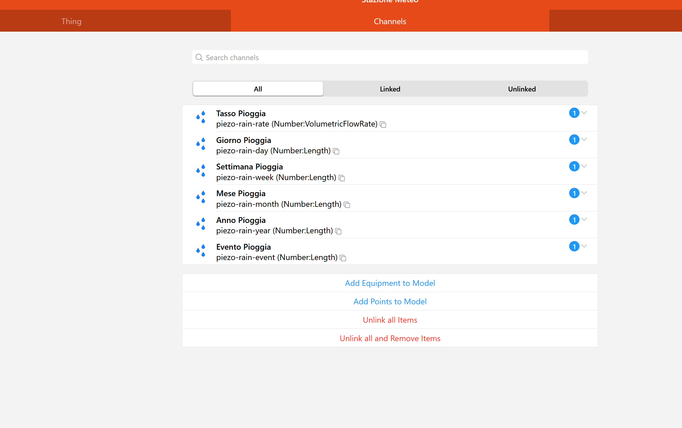

but still I have problems with items, they appears and then disappears continuously (from today) all channels disappears then re-appears:
I installed via karaf but I have always this on my log:
Failed to convert state '0 mm/h' to unit 'l/min'. Please check your item definition for correctness
and items on sitemap and settings, appears and disappears.
The unit was changed b/c it was wrong.
This was discussed before in this thread. I think you are running a second service, which queries the gateway.
I resolved removing the item and re-adding it
