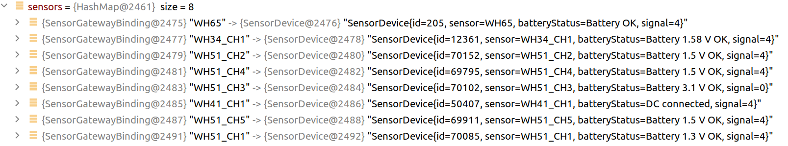

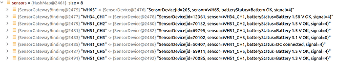

The data parsed by the binding meet your expectations:
My guess is that the item in OpenHAB is configured in such a way that only one fractional digit is displayed.
Perfect! I have found a conversion issue. The current build should work with your device now! Please test it and give me feedback?
