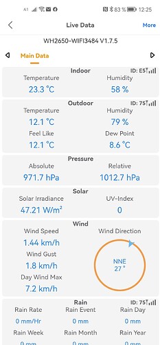

I just set up my new weather station, it’s a WH 2650, everything went smooth during setup.
There is just one unit not displayed at the channel irradiation-uv.
In the WSView Plus app you can swith between irradiation-uv and illumination, the unit is displayed in the app but the channel irradiation-uv in OH stays at 0.

Screenshot_20221107_122520_com.ost.wsautool
any help appreciated
If I decode your data, I get the channel irradiation-uv with the value 4.2 mW/m², so OpenHAB should show this value with an appropriated unit.
I just checked my item, it stays on 0, if i change the statedescription to %.5f the item show 0.00380,

You are right @Rolli
I have also a 2650 and the “irradiation-uv” also shows in OpenHAB 1/10000 of the reported value in the mobile app. But I do not use this channel for any automation in OpenHAB (only index-uv).
and
As mentioned above:
This seems to be a bug in OpenHAB. The binding returns the value as QuantityType with the unit mW/m². There should be no such differences in scale.

I’m a bit worried TBH - it feels like maybe for all my care in trying to get the right kind of station, I may have ended up with one that doesn’t actually communicate properly? Or is it just something that needs some further tweaks to the binding (or my setup) to get it running?
First of all, can you connect to the device with the WS-View Plus app and read the data?
If so, please connect the WS-View Plus app to the proxy and provide the logs.
NOTE: OpenHab must not be connected to the proxy.
If so, please connect the WS-View Plus app to the proxy - not your OpenHab - and provide the logs.
From the logs you provided, I can see that you are not getting any responses to the live-data requests. Also the response for CMD_READ_FIRMWARE_VERSION does not have the correct format.
The WSView Plus app connects to the device, but the only ways to read data seem to be through “Dashboards” that appear to require web uploading… but that seems to be the app that behaves that way, not the device? As in, I can see nothing in the app that would allow me just to view a station rather than configure it to upload to ecowitt, wunderground, etc. It just doesn’t even seem to be part of the WSView Plus interface to view a weather station’s data until it is connected to the ecowitt or wunderground websites.

It seems like I may have bought a lemon (which wouldn’t be classified as that, because it works beautifully as they intended, just not as I intended).
This is the problem with the gateways with display, these cannot be read out in the same way as the gateways without any display.
So you have 2 options:
  1. use IpObserver - Bindings | openHAB
  2. buy a LAN & WiFi Gateway (like GW1000, GW1100, GW2000, …) for reading out the data with this binding
Further question - if I do end up having to buy other hardware (e.g. a GW1100) to get the FineOffset binding working, would I be able to leave the display unit connected, or will the sensors only talk to one base station at a time?
A very good question, which I unfortunately cannot answer. But if you try it, then we would be happy about your feedback here.
Excellent - I may as well be a guinea pig! :slight_smile:
