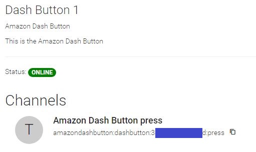

How do i add channels too my sitemap
Im using a few Amazon dash buttons with my setup and want too be able too simulate a button being pressed from the sitemap so rules can run without actually pressing the physical button
change the channel too pressed from my sitemap
Amazon Dash Binding does not use Items only things and channel and i dont know how too add these

You can’t.
If you want trigger that rule just create an item for the Sitemap and added that item as a trigger to the rule.

You can add things liked to items in the sitemap but not to channels…

But amazon dash doesn’t use items only a thing and a channel so it seems this can’t be added
@rlkoshak thanks for that I know I can add a proxy item too fire the rule I just wanted too add it directly I might use this approach though

As I’ve said in other posts, Items are the coin of the realm. Rules mostly work on Items. Persistence exclusively works with Items. Sitemaps and HABPanel exclusively work with Items.
I’ve never been a big fan of the triggering Channel events because it breaks this nice clean division between Items and Things. It sets up expectations that you can do more with Things. But the purpose of them is to avoid the awkward approach that was used previously of a Switch that gets momentarily set to ON and immediately set back to OFF. Since all you care about is the event, the devs set up these triggers so you can trigger the Rule on the event straight from the Channel rather than requiring an Item. But the assumption is that this event is ephemeral. There would be no reason one would want to keep this data around in an Item or the like. So from this perspective it makes no sense to be able to assign this type of Channel to an Item.
