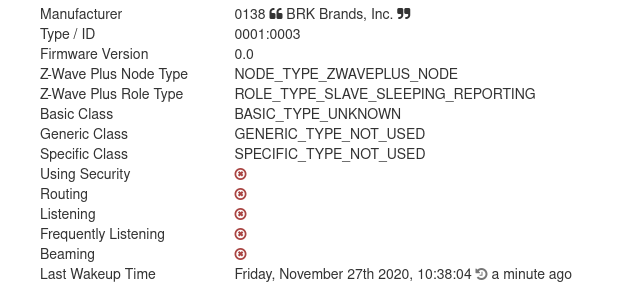

Here are the attributes. thanks for the hint on Habmin ! (The wakeup was me pulling the battery tray)
OK… you have the 0001:0003. It doesn’t look all filled in though (not fully initialized). You may need to wake it up a few more times, which should involve holding the Test button while inserting the batteries. It looks like you have this down, since it woke up a minute ago. Does Habmin show the Thing as initialized? If not initialized, you will see what stage of initialization it is in… Request NIF, etc. A quick way to check is to look under Tools> Show advanced settings> and see if ‘Reinitialize device’ is in the menu. I’m not suggesting to select it, just check for its presence. You will only see that if the device is initialized.
It says “Node Initializing: VERSION” , and no “Reinitialize device” is listed.
More wakeups needed :slight_smile:
