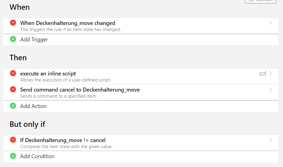

To simplify the usage of the mount, I created a rule that sends the command “cancel”, whenever the according item is set to a state that is not “cancel”. To not send two commands to the device in a very short time, I have inserted an inline script as the first action which does nothing but just waiting for 400 ms.
Here is a screenshot of this quite simple rule:

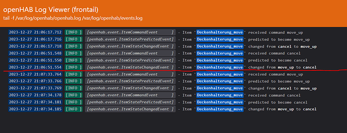

Now the problem is that whenever openhab is restarted - or even only saving the rule again without doing any changes - the first execution of this rule does not take 400 ms like it should, but about 33 seconds, until the “cancel” command is send.
Here is a screenshot of the logs, where I triggered the rule twice after saving the rule. I separated the two executions in the logs with the red line:
As explained, the first execution takes in this case nearly 34 second, while the second execution (and every following one) only takes the expected 400 ms.

This is a well known issue on 32-bit ARM processors (e.g. what an RPi runs on). The first time a JS Scripting rule is run after it gets loaded requires the Helper Library to be loaded. On 32-Bit ARM this appears to take 20-30 seconds.
There is evidence that running on an x86, amd64 processors or running 64-bit OS and Java even on ARM processors reduces this initial delay down by 10x (so 2-3 seconds).
If that isn’t an option for you, you will need to use something other than JS Scripting or Blockly for this specific rule. Note that for different reasons Rules DSL also will have a noticeable delay the first it’s run. In truth all the rule languages will be slightly delayed the first time it’s run. But jRuby’s delay at least will be pretty short. Nashorn JS is also very short as there’s no library to load at all.
