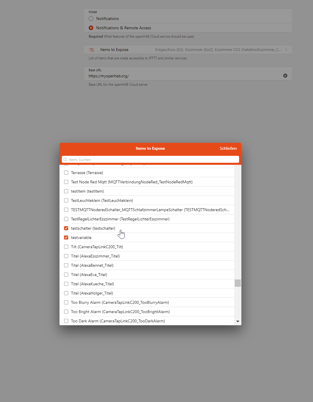

  2. Exposed the switch to myopenhab (although I can’t find it there; from older documentations I’ve read that used to be the case, but that might have changed by now)
  3. Installed the alexa-skill and connected it to the myopenhab-account
  4. When clicking “search devices” no new ones are found; especially not the “testschalter”-switch I created in the beginning. It doesn’t show under “all devices” or “switches” either.

Don’t Expose items, this was only needed for IFTTT. You need to properly tag your items.
