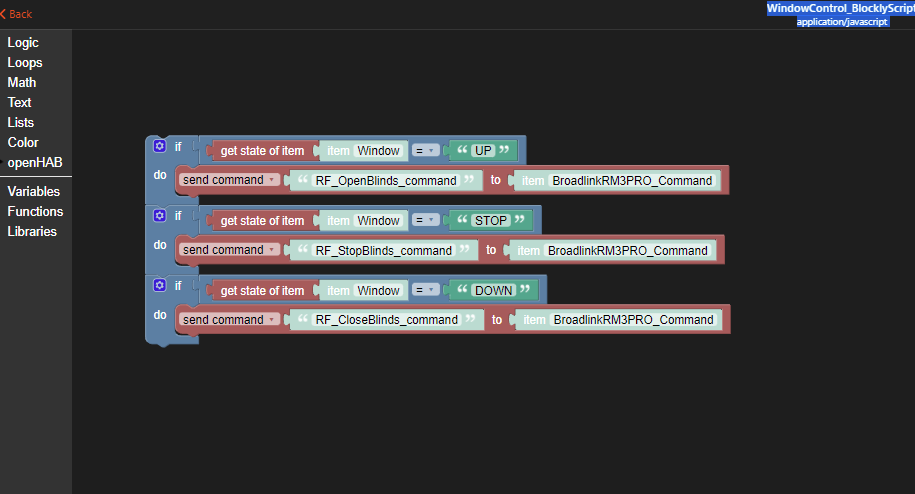

Here is a video. In the video, I show how I setup a single rule for one UP button(work solution) and how I setup one rule for all three buttons(not working).
The video is helpful, but you can also just copy and paste the code of the rule next time if you want.
As already mentioned before state and command are different, therefore your 2nd example is not working.
The command is UP but the state will change to 0 (if state is different then 0) or will not change at all (if it’s already 0).

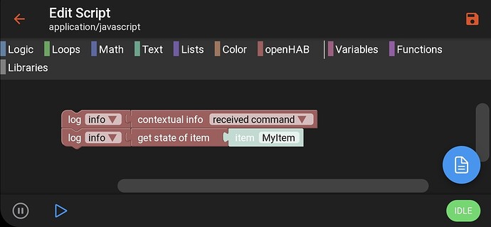

Do the following, with your “not working” rule:
From the actions section remove the action to execute your script, but define the blockly code directly in your rule (new action → run script → blockly)
Add logging for received command (available within openhab → run & process → contextual info) and item state and test your rule. This should give you the expected results and show the difference between command & state.
Then you can rebuild your logic with received command instead of item state.

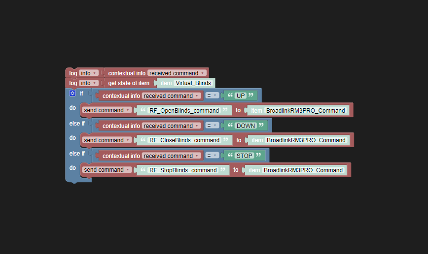

Here is the new code in one blockly script (i put it inside the rule structure as Matze suggests).

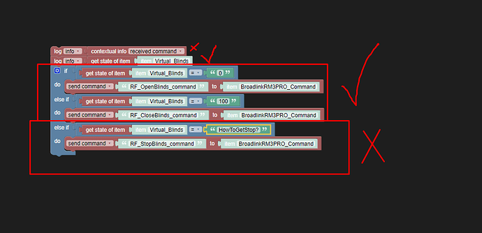

Now I get working Up/Down function in “one” file.. but how to get a Stop? Also “received commands” do not work and return “undefined:sob:
PS because my device (windows opener) does not support any feedback (it only accepts Open/Stop/Close Commands) I want to crate and save a custom global variable (to check if it is moving true/false) is this possible in blockly?

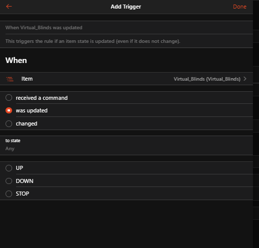

The rule should be triggered by item → received command
If the rule is triggered manually for testing or by item → change, then you will receive the “undefined”
The trigger rule for a single file is:

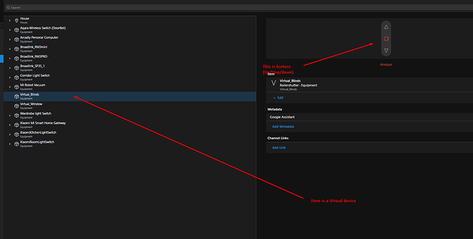

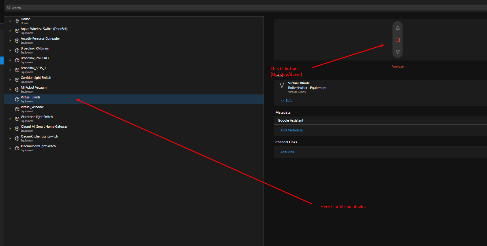

By buttons and virtual (a device that doesn’t have representation in “Thing” menu) devices I mean this:
I try to get access to the “received command” because I think maybe this can help me get Up/Down/Stop signals from “Virtual device” that show in a log message:
Problem was that I use my blockly script in the wrong trigger option “was updated”, but after the last message from Matze0211 I change it to “received a command” and now my script can execute “received command” and work as i need. So, for now, I think all work ok.
