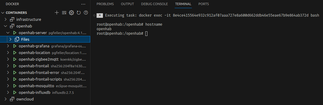

I use visual studio code with the recommended docker extensions - this will help you to e.g. have a look at the logs and to open a shell inside the container; but there are other tools that provide good support as well … e.g. portainer.

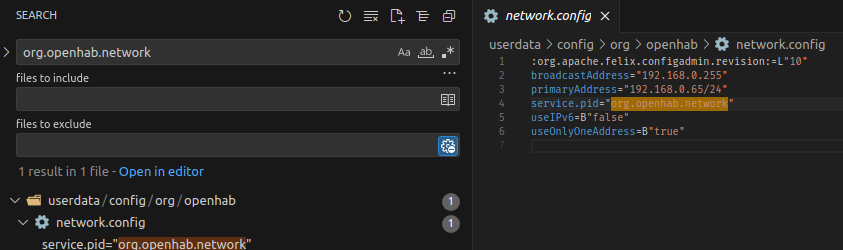

Digged a big arround - and not sure if OPENHAB_HTTP_ADDRESSwill have an effect; but the following config file might be of interest userdate/org/openhab/network.config:
