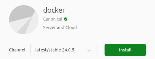

  • Install docker from App Center

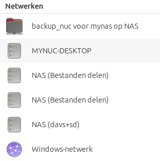

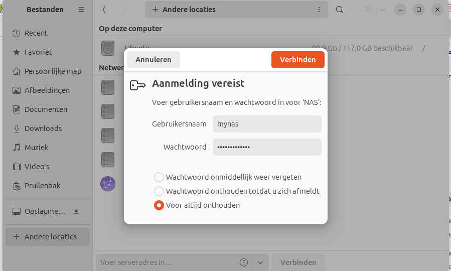

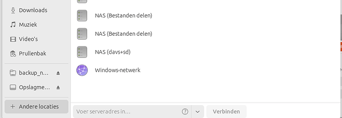

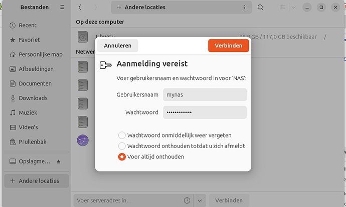

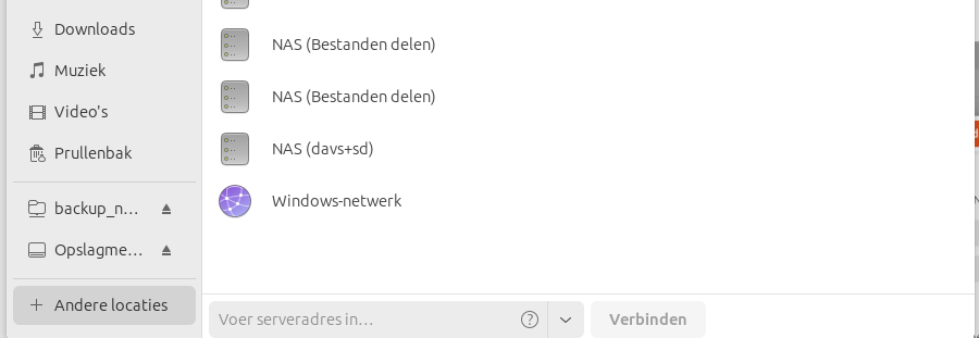

  • Map a shared folder from the Synology with the NUC
    You should see NAS. Select the first option and login with your Synology credentials.
  • Now you should see the NAS
