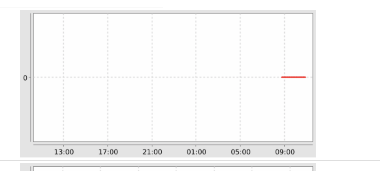

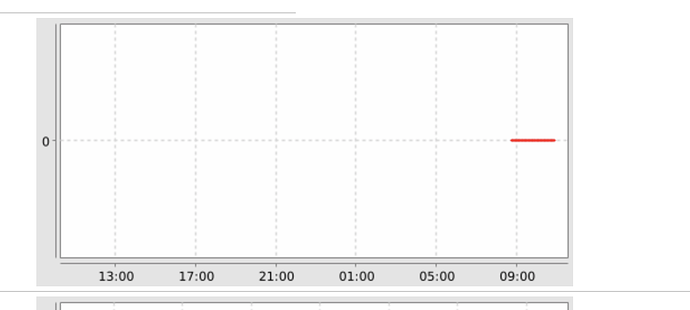

For some Items graphs generated based on rrd4j are “flat”, e.g.
I observe the following:
.items:
Number SpeedtestResultDown “Downlink [%.2f Mbit/s]” (gSpeedtest)
openhab.log:
2020-11-03 10:45:02.327 [DEBUG] [g.openhab.persistence.rrd4j.internal.RRD4jPersistenceService] - Stored ‘SpeedtestResultDown’ with state ‘821.00481118472’ in rrd4j database
2020-11-03 10:45:22.849 [DEBUG] [g.openhab.persistence.rrd4j.internal.RRD4jPersistenceService] - Stored ‘SpeedtestResultDown’ with state ‘821.00481118472 Mbit/s’ in rrd4j database (again)
2020-11-03 10:45:22.850 [DEBUG] [g.openhab.persistence.rrd4j.internal.RRD4jPersistenceService] - Stored ‘SpeedtestResultDown’ with state ‘646.5112701904’ in rrd4j database
2020-11-03 10:46:01.800 [DEBUG] [g.openhab.persistence.rrd4j.internal.RRD4jPersistenceService] - Stored ‘SpeedtestResultDown’ with state ‘646.5112701904 Mbit/s’ in rrd4j database (again)
I have wiped the .rrd4j files as well. It seems that the Item state is stored twice in the database, once with and once without the unit. I am also puzzled by the timings (it is EveryChange, EveryMinute as policy)
What is causing the flat charts?
