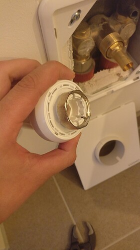

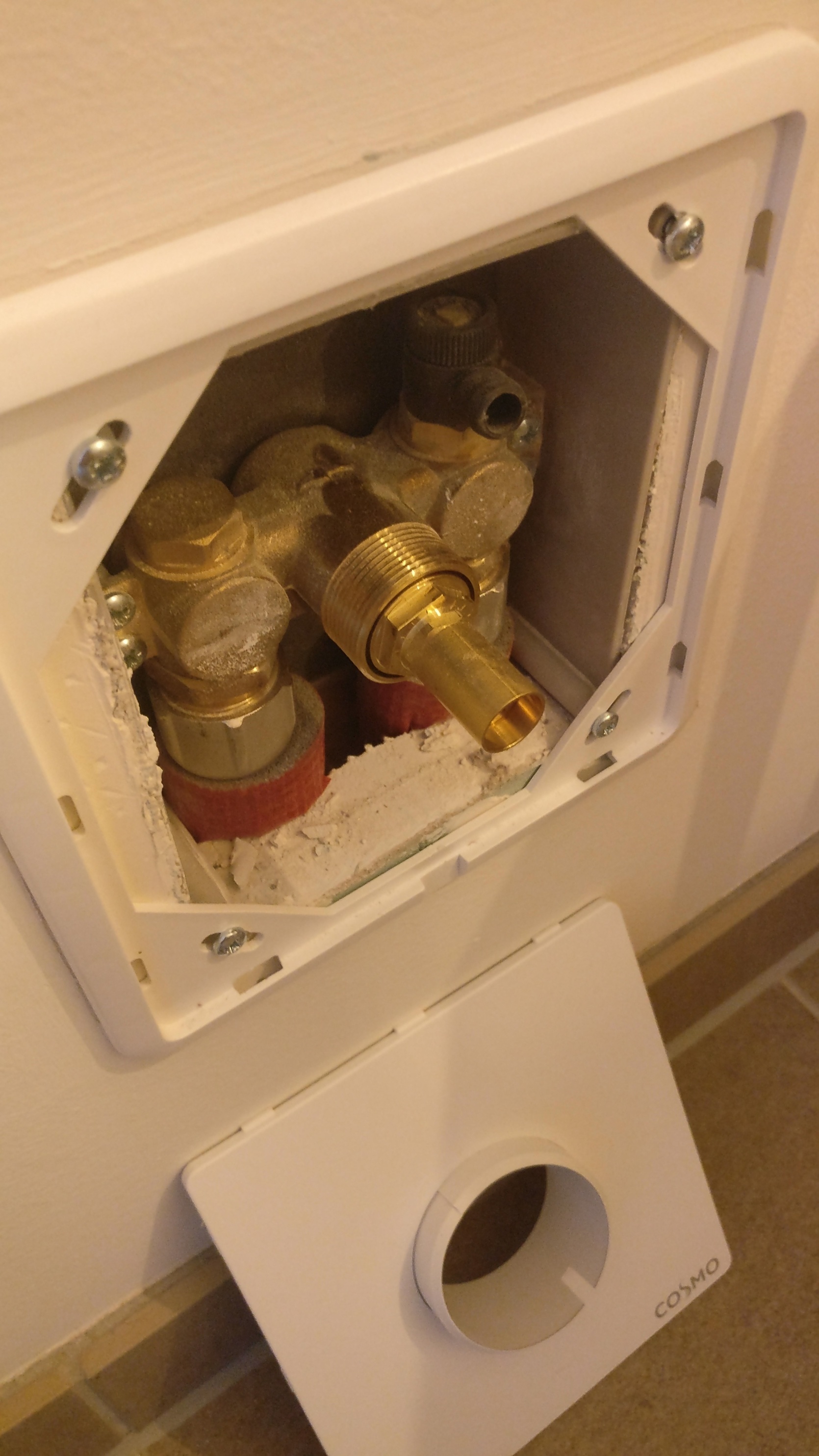

I am looking for a controllable thermostat for my COSMO water rtl sub floor heating valve.
I have already contacted COSMO but they did not have a solution for me (the answer did not seem very competent tbh).
Maybe there is an adapter to connect a regular wall thermostat?

I would like to have a openHAB2 compatible mechanism to control the pictured valve. So looking for hardware recommendation. I don’t mind if it is z-wave, 433mhz or any other protocol but it should work with openHAB.

You could try the MAX! series. I have some of those thermostats and the connector looks the same, they also come with 3 adapters. There’s a thermometer in the thermostat, but a separate wall thermometer is also available.
To control MAX!, you need the MAX!cube, and with that one, you can also control them from openHAB. Get a starter kit.
But don’t blame me if it’s not compatible, hard to tell based on just a picture.
Thanks for the recommendation. I was actually looking into the MAX! system.

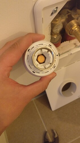

It seems that the RTL system means that the temperature is measured inside the thermostat and the heat is transmitted via the metal plate (it’s a plate not that small “knob” on regular wall thermostats).
However, could you post a picture of the adapters? I can’t find it on the internet right now.

Afaik RTL thermostats are completely different because they measure the water temperature which is going through the floor heating pipe (not the air temperature). This is important because my heating engineer told me that you might destroy your floor tiles or burn your feet when water more than 40 degree (approx; I dont remember the exact figure) is sent through the pipe.
