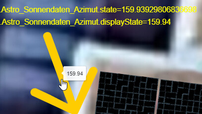

I’m using the latest openhab version and I want to visualize an arrow inside a floor map. This arrow (f7:arrow_up) icon should be rotated and show the actual sun direction. (azimut).
The value is from the astro binding. Background: I want to visualize the direction of the sun in a floor map that shows my solar panels at the roof top and the panels values.
This is the item:
Using the value inside the floor map shows for state and displaystate the following output:
Using this value inside a marker does not work.
I think the problem is that the item state includes the degree Symbol? Or is it because it has decimal values? Is there a way to format the value as integer to use it insider the floor map?
