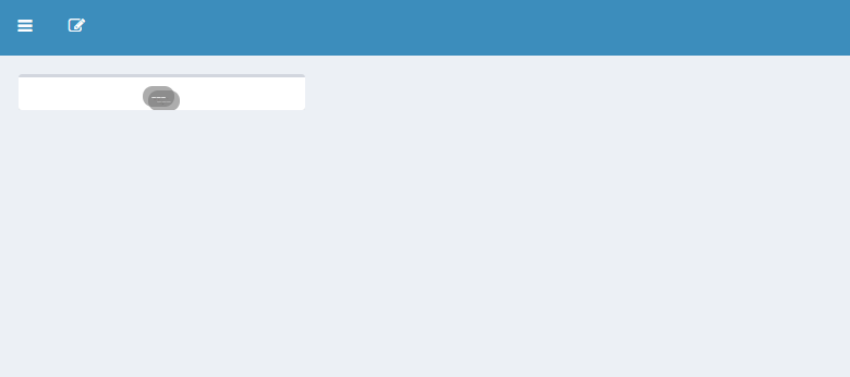

I want to use the floorplan editor in Habmin. I uploaded a JPG File and added a item on it.
When I go to my Habmin Dashboard there is only my item.
Can someone help please?

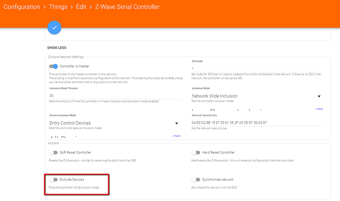

Is that still the case? 2.5M1 PaperUI looks pretty complete. I only do a couple of zwave things in HABmin due to familiarity.
The way that PaperUI updates Zwave device parameters is suboptimal. There is no network map in PaperUI. I don’t think you can put your Controller into exclusion mode in PaperUI.
The option is there.
