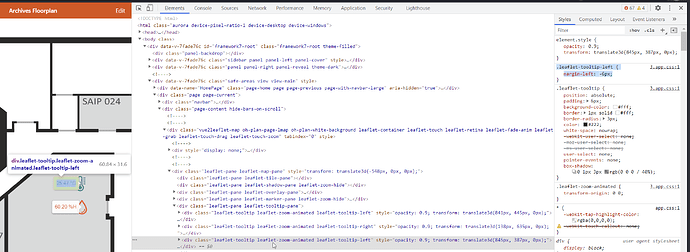

unfortunately in the syntax I providede one post up it does not. My coprehention of the CSS is very basic. I might have messed up something. This is the exact inspect
That I need to fix the margin for.
Hmm…as I said, I don’t know if the stylesheets are supposed to work with the floorplan pages. It looks like leaflet-tooltip-xxxx should be appropriately downstream so I’m not sure what’s going on.
