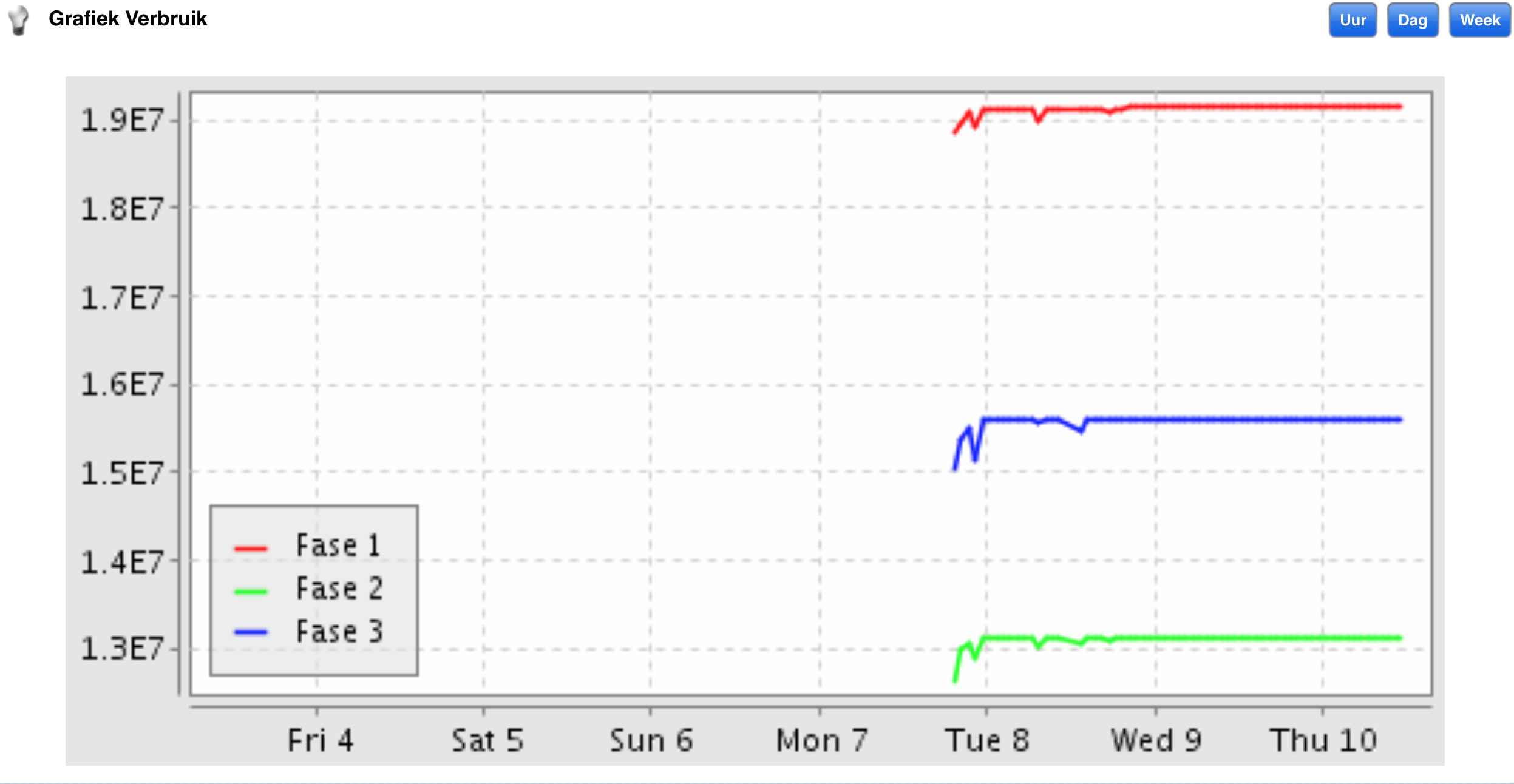

I finally managed to get the values displayed in OpenHAB. But this does not bring to the point I want to go.
The values are pulses and do not give me the consumption per phase.
items
Number Flukso1 "Fase 1 [%.2f]" (gFlukso) {mqtt="<[mosquitto:/sensor/sensorId/counter:state:REGEX(.*,(.*),.*)]"}
Number Flukso2 "Fase 2 [%.2f]" (gFlukso) {mqtt="<[mosquitto:/sensor/sensorId/counter:state:REGEX(.*,(.*),.*)]"}
Number Flukso3 "Fase 3 [%.2f]" (gFlukso) {mqtt="<[mosquitto:/sensor/sensorId/counter:state:REGEX(.*,(.*),.*)]"}
sitemap
Frame label="Flukso" {
	Group item=gFlukso label="Verbruik"{
	Switch item=gFlukso label="Grafiek Verbruik"mappings=[0="Uur", 1="Dag", 2="Week"]
	Chart item=gFlukso period=h refresh=300 visibility=[gKNXTemp==0]
	Chart item=gFlukso period=D refresh=1800 visibility=[gKNXTemp==1]
	Chart item=gFlukso period=W refresh=3600visibility=[gKNXTemp==2]}
How can I convert the pulses into consumption (like WH or KWh)?
