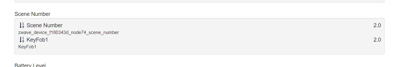

In HABmin, you can actually see the scene numbers from the Fob:
If you don’t, your rule will never trigger.
Check that first.
