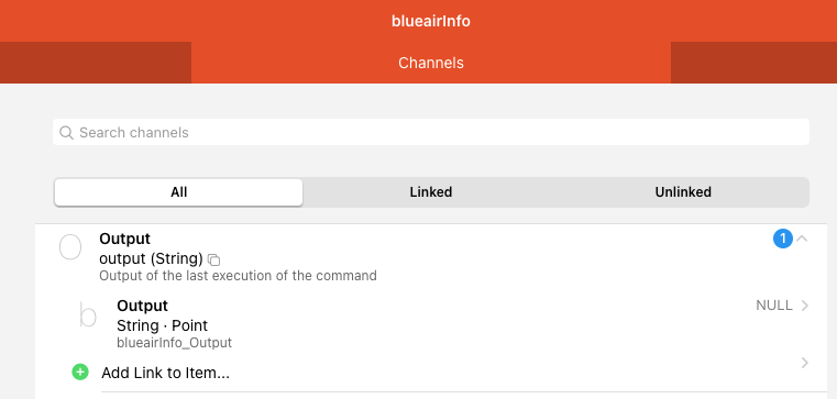

Installed the binding successfully, but some issues remain. I’m able to get valid status information when I run “index.js 0 info” from the command line (debug on), but in the UI there are only null values?
Have to admit that I’m not very familiar with openHAB “native” usage, as I’ve only used REST API in the past, querying values outside openHAB.

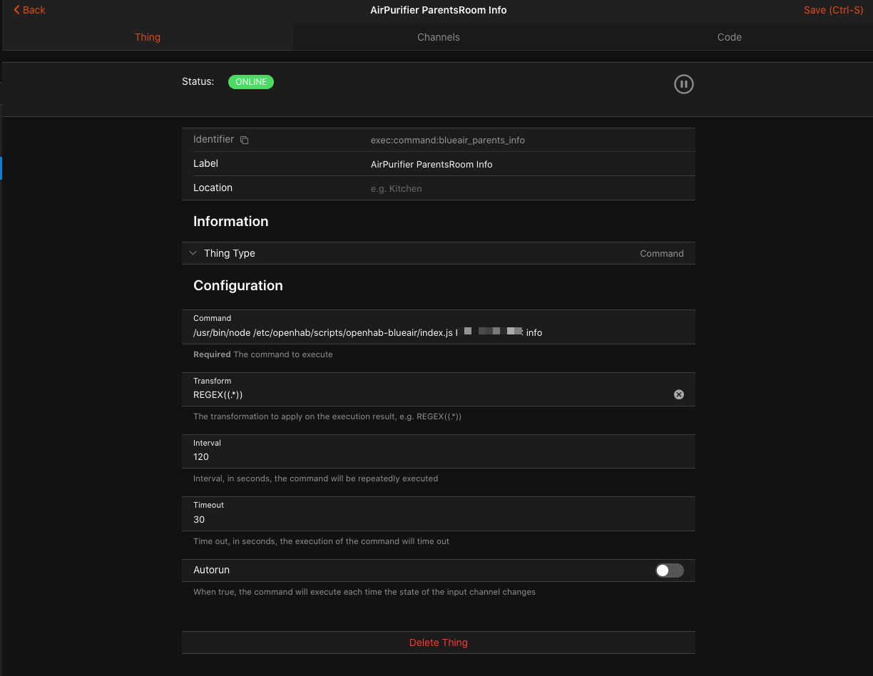

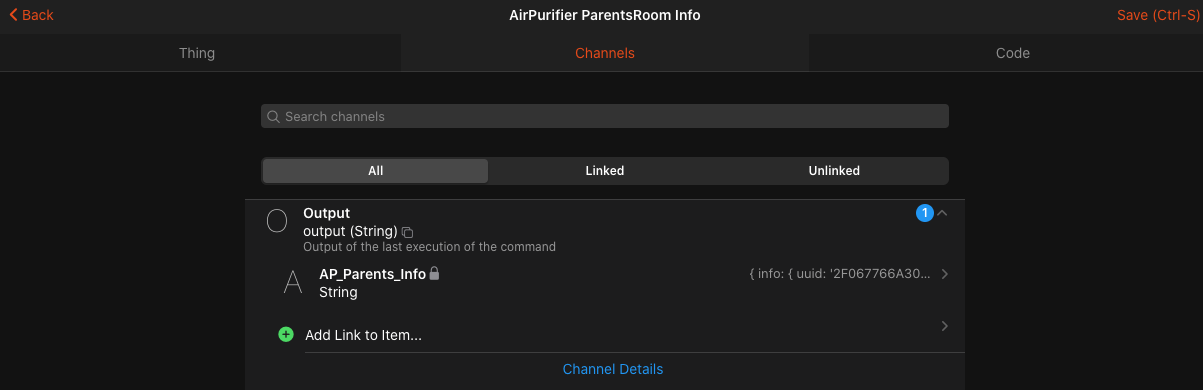

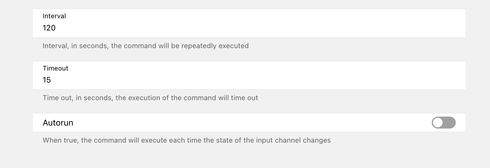

You should be seeing something like this:

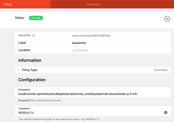

Here’s what my Thing settings look like:
Hope that helps

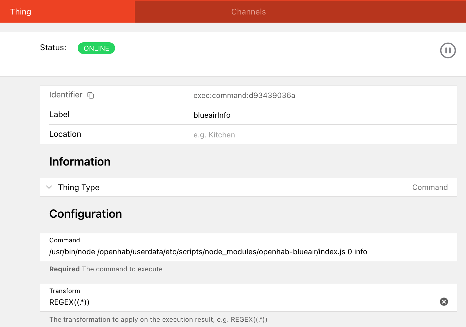

Debug is off, but still not seeing the same info on UI, my config below:

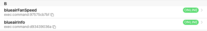

Btw, about your installation instructions where you point to Items, there’s e.g. “…exec:command:f0ad9cd4…” string that I assume should reflect the identifier shown on openHAB UI. Just something you could clarify on those instructions.
