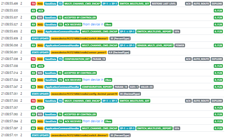

I can’t really track down to when this behavior started, if this was with the 4.0 upgrade, 4.1, or some patch in between.
When I now try to send a value manually from the CLI, it does seem to stick.
openhab> openhab:status HallwayLight_ForceInitialBrightness
35
openhab> openhab:send HallwayLight_ForceInitialBrightness 85
Command has been sent successfully.
2024-01-26 12:17:28.544 [INFO ] [openhab.event.ItemCommandEvent ] - Item 'HallwayLight_ForceInitialBrightness' received command 85
2024-01-26 12:17:28.546 [INFO ] [penhab.event.ItemStatePredictedEvent] - Item 'HallwayLight_ForceInitialBrightness' predicted to become 85
2024-01-26 12:17:28.547 [INFO ] [openhab.event.ItemStateUpdatedEvent ] - Item 'HallwayLight_ForceInitialBrightness' updated to 85
2024-01-26 12:17:28.547 [INFO ] [openhab.event.ItemStateChangedEvent ] - Item 'HallwayLight_ForceInitialBrightness' changed from 35 to 85
2024-01-26 12:17:28.619 [INFO ] [openhab.event.ItemStateUpdatedEvent ] - Item 'HallwayLight_ForceInitialBrightness' updated to 85
2024-01-26 12:17:30.091 [INFO ] [openhab.event.ItemStateUpdatedEvent ] - Item 'HallwayLight_ForceInitialBrightness' updated to 85
2024-01-26 12:21:48.372 [INFO ] [openhab.event.ItemStateUpdatedEvent ] - Item 'HallwayLight_ForceInitialBrightness' updated to 85
side note: since 4.0 I see a lot more ‘updates’ in the event log, whereas it used to only log changed values, it now seems to log every value that is polled.
Any ideas on how to troubleshoot this would be welcome!
