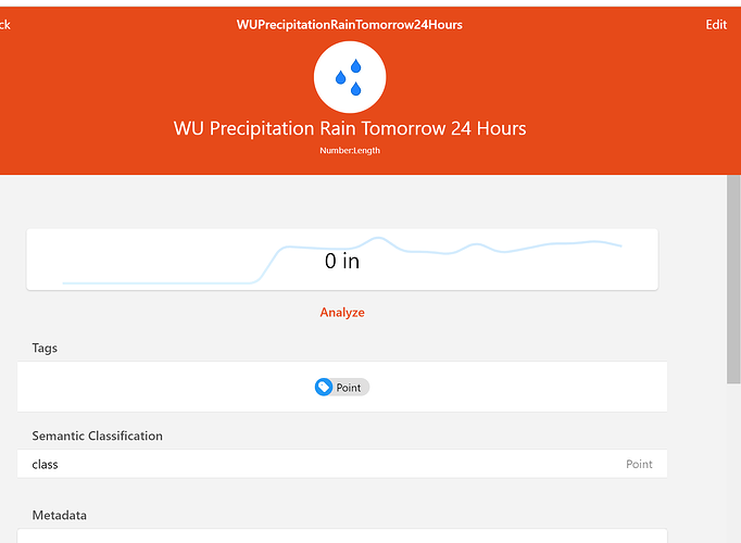

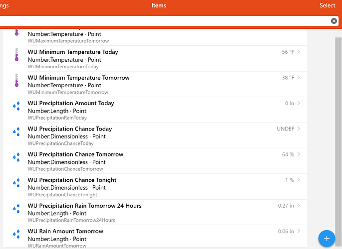

I got set up with the weather company binding/wunderground, its all working well, I am having a slight quirk though. The forecasted rain amounts show up on the items page(As seen at the second from the bottom of the first photo), but not when I click on said item, nor does it show any amount in the app, just 0. It is obviously getting the data and storing it in some form or fashion though because it’s graphing the information… Do I just have some not set right? The rainfall amounts are the only items that do that…
It’s almost certainly rounding the value. Add State Description metadata and set the pattern to %.2f in which will round to two decimal places instead of to the nearest inch.
That was it, Thanks!!
