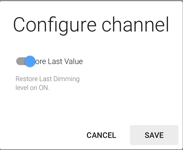

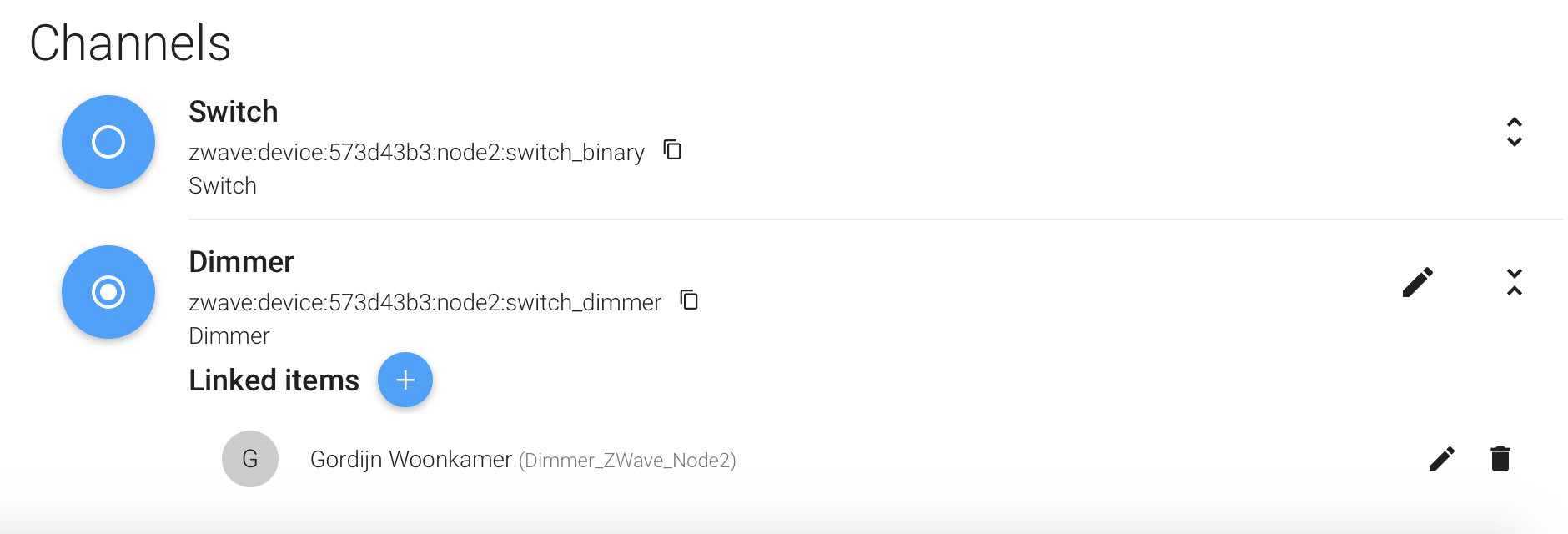

i have 2 Forest shuttle blinds. works perfectly only the close button opens the blind and de open button closes the blind. also the percentage is not correct, 100=0 0=100.
how could i add [invert_state=false and invert_percent=true] parameters to the dimmer channel. or how can i change the channel to blind?

I changed the channel in the database, you need to upgrade your zwave binding to the latest snapshot as soon as the changes got merged.
https://www.cd-jackson.com/index.php/zwave/zwave-device-database/zwave-device-list/devicesummary/510
