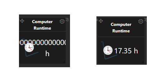

I have an item which comes in seconds and I would like to display this in hours (2 decimal digits). I have googled and searched a bit and found that item transformations might be able to do that. I have therefore done a
Math.round(%d/60/60) h
in the Item Metadata (State description). When I use the value in a page, I can see that the rounding is not properly done (left part of the image). However, when I wait ~2 mins, the value is displayed as I intended (right part of the image):
I am wondering why the display switches after a few minutes and what I can do to always have the intended formatting.

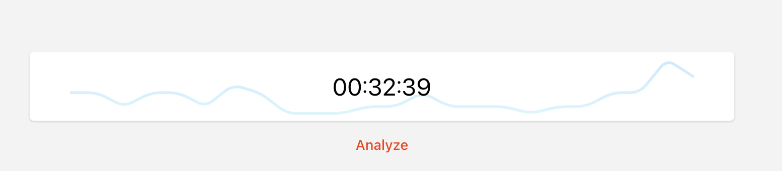

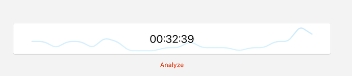

If you use a Number:Time Item, you can use date time formatting to create HH:MM:SS formatting to format the value without a transformation.
For example, a Number:Time Item with a state of 1959 s with a State Description Pattern of %1$tH:%1$tM:%1$tS shows
