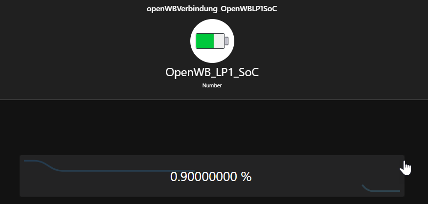

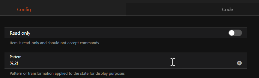

I’ve got an item that displays a percentage value as “0.91000000 %” which I’d like to be shown as “91 %”. So I went to item’s metadata/state description/pattern and entered “%.2f” (don’t know what that means but found it in the forum). But that doesn’t work. Where’s my mistake?
It means "floating point number (f) rounded to two decimal places (.2).
This is a plain old Number Item. I’m guessing that the Channel linked to this Item is reporting a percentage as a “real” percentage (i.e. a number between 0 and 1). So you will have to transform that 0.90 to 90 by multiplying it by 100 in a JavaScript Transformation.

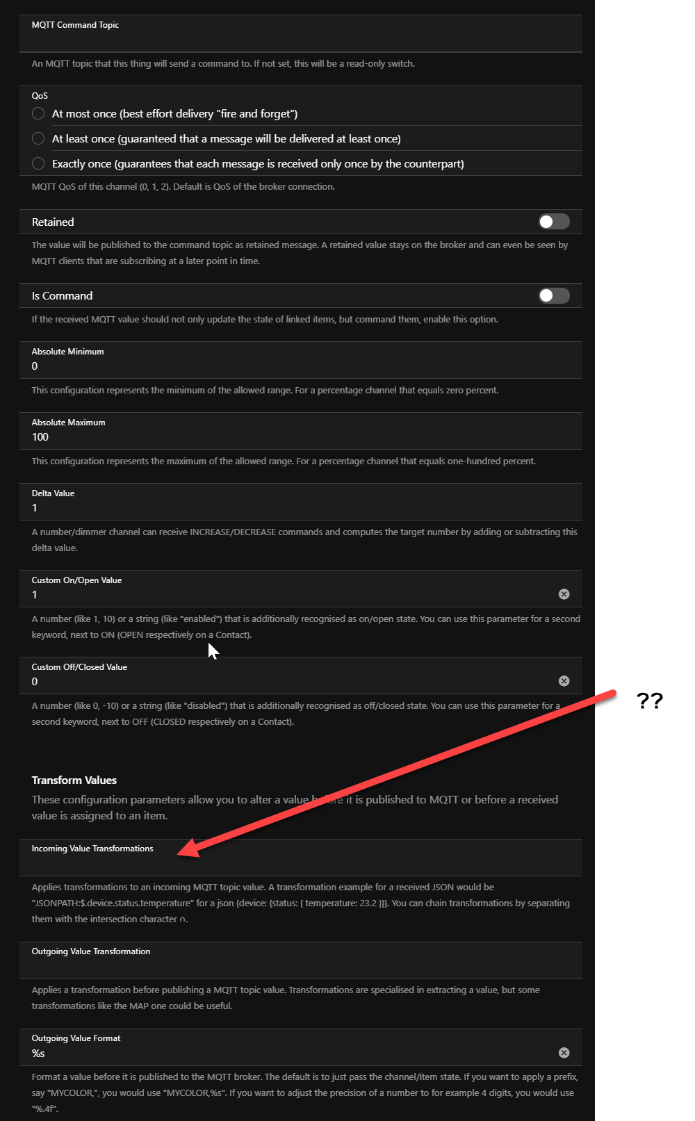

Since you are using the MQTT Binding, add a JS transform to the “Incoming Value Transformations” field of the Channel config.

I’d imagine that “Incoming value Transformations” is to be addressed. If so, do you know what to enter there?

For now, the appearance is the only thing I need. So if I understood correctly, one line of code entered in “incoming value transformation” should be sufficient. Could you tell me (or hint at) the javascript-code for the incoming value transformation, please?
No, you need that now. You must create the JavaScript function I posted above. You must put it into a file ending in “.js” in the transform folder. Only then can you put the JS:nameoffile.js into the Channel config.
I literally posted it above.
Though I notice I forgot to multiple by 100.
(function(i) {
    return parseFloat(i) * 100;
})(input)
Thank you, Rich, it works fine!
