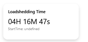

Hi All
I would like to format the value for string item. The string is holding a date. I have defined statedescription pattern and it shows up as undefined
The yaml code for the widget is below
component: oh-label-cell
expandable: false
item: loadshedding_counter
stateAsHeader: true
title: Loadshedding Time
footer: '= "StartTime: " + items.ld_StartTime_item.displayState'
the statedescription pattern is below
value: " "
pattern: "%1$tY.%1$tm.%1$td %1$tH:%1$tM:%1$tS"

Thank you Sebastian, yes that works but i would like to display the date differently hence i attempted using pattern

I assume your item is of type datetime. That would work. In my case, my item is of type string hence my challenge. The above works on my items which are datetime. Iam needing to format an item which is a string type.

This should work:
footer: '= "StartTime:\ " + dayjs("2023-11-08T04:00:00+02:00").format("YYYY.MM.DD HH:mm:ss ")'
footer: '= "StartTime:\ " + dayjs(items.ld_StartTime_item.state).format("YYYY.MM.DD HH:mm:ss ")'
The description of dayjs().format you can find here
I hope it helps better
zizebra
(Zizebra)
November 6, 2023, 9:53am
7
Brilliant that is it. Just wwhat i wanted.
