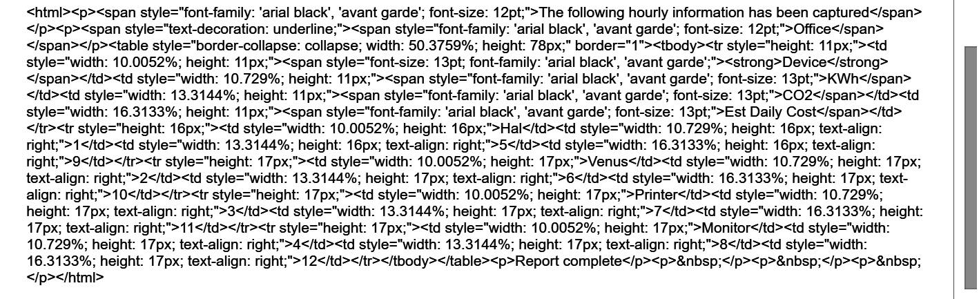

Unfortunately that did not work and top close the gap I have included a screenshot of what turns up in my gmail email destination. in case it provides a clue.
I am thin king we do not have a way to specify the correct content-type mail header.

Does the code render properly if you save it as an HTML file and open in a browser?
I have removed all the escaped ’ and " characters
and added the html tags and also a the DOCTYPE line to the top.
See the attached txt file which I have given a pdf extension to allow it to be uploaded, simply rename the file extension to html and it will load into a browser nicely

Are you certain that your email client is configured to render HTML email? I’m really at a loss as to what else could be wrong.
I was going to try to paste the HTML into an email to send to myself but the PDF won’t load for me.
the pdf is no pdf at all :slight_smile: I had to download it manually and change the .pdf to .html
Ah. OK I tried to compose a message by hand and it comes over as all text too. I’m not sure what I did special previously.
