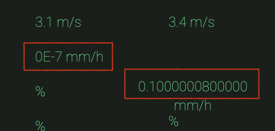

The problem is that the following widget code (1) provides the result below, and (2) doesn’t work - I assume because it is a string. Am I doing something wrong or what do I have to do to format the number value as I want?
<!-- (1) -->
<div class="name green">{{itemValue('Precipitation_d2')}}</div>
<!-- (2) -->
<div class="name green">{{itemValue('Precipitation_d2') | number:1}}</div>
