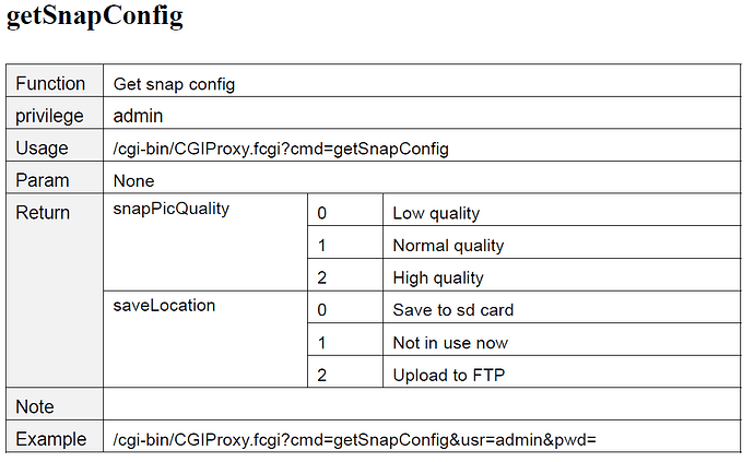

What does
return (if supported by your camera …)?
