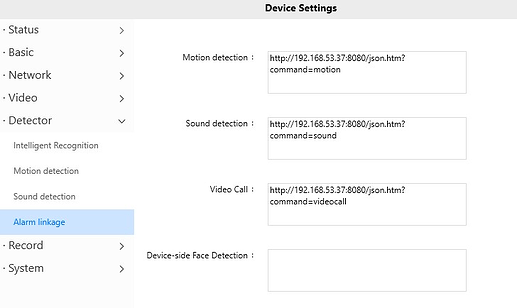

I have a Foscam VD1 from which I would like to get the information that someone has operated the doorbell button.
Has anyone ever integrated the function. Unfortunately, I do not get on here. I have made the setting under VMS (Foscam software) but do not get on.
The VD1 with the IP Camera Binding works, also the readout of cgi information.

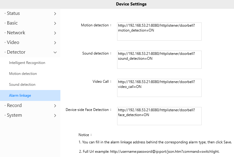

I have managed to read the function doorbell button (or in VMS video call).
First you have to know that the VD1 sends a GET request when the doorbell button is pressed. So I installed webhook (https://github.com/adnanh/webhook) and looked what happens here and saw how the data looks like in wireshark.
The integration itself I have integrated via httplistener binding (https://community.openhab.org/t/webhook-new-very-simple-binding-for-listening-incomming-http-requests/123597) the configuration in the http listeren binding looks like this.
UID: httplistener:HttpListener:doorbell
label: Doorbell HttpListener
thingTypeUID: httplistener:HttpListener
configuration:
  jsonConfig: |-
      "channels": [
          "key":"motion_detection",
          "kind": "STATE",
          "state": "req.parameters.motion_detection[0]"
         "key": "sound_detection",
         "kind": "STATE",
         "state": "req.parameters.sound_detection[0]"
         "key": "video_call",
         "kind": "STATE",
         "state": "req.parameters.video_call[0]"
         "key": "face_detection",
         "kind": "STATE",
         "state": "req.parameters.face_detection[0]"
With the channel video_call I have linked an item with which I can e.g. trigger a bell or a speaker or simply send a notification.

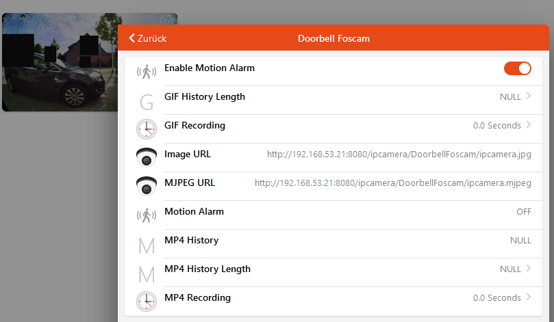

Thanks for the Answer @Jeff_Smart , I’m also just starting with the ipcamera plugin.
Good to hear that the doorbell is at least compatible with that.

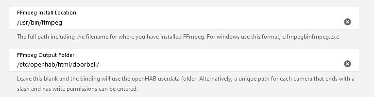

If you (@FranzS ) want to use the recordingGif function you have to install FFmpeg (see IP Camera Binding). recordingMP4 does not work for me. The files are copied into the FFmpeg Output Folder (things settings).
Unfortunately I don’t have an idea how to display the created files (if there are several) one by one. There is the HABpanel widget Custom Widget: Camera History and Live Popup but I don’t want to use HABpanel.
My FFmpeg setting in the things setting
