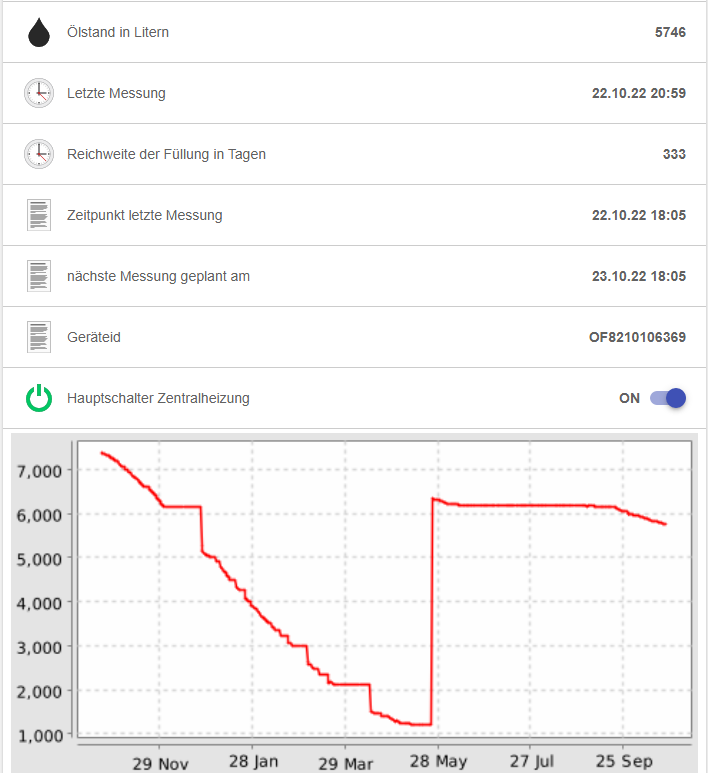

I had the same problem about a year ago. My workaroud was using FHEM and sending the data via MQTT to openhab. The FHEM-Plugin ist working fine. The installation of fhem on the openhab server does not require a lot of resources.
In openhab it looks like this:
