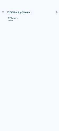

Sorry I did not now but next time I use the code thing. Here is the picture the number is in the next line. not right on the text

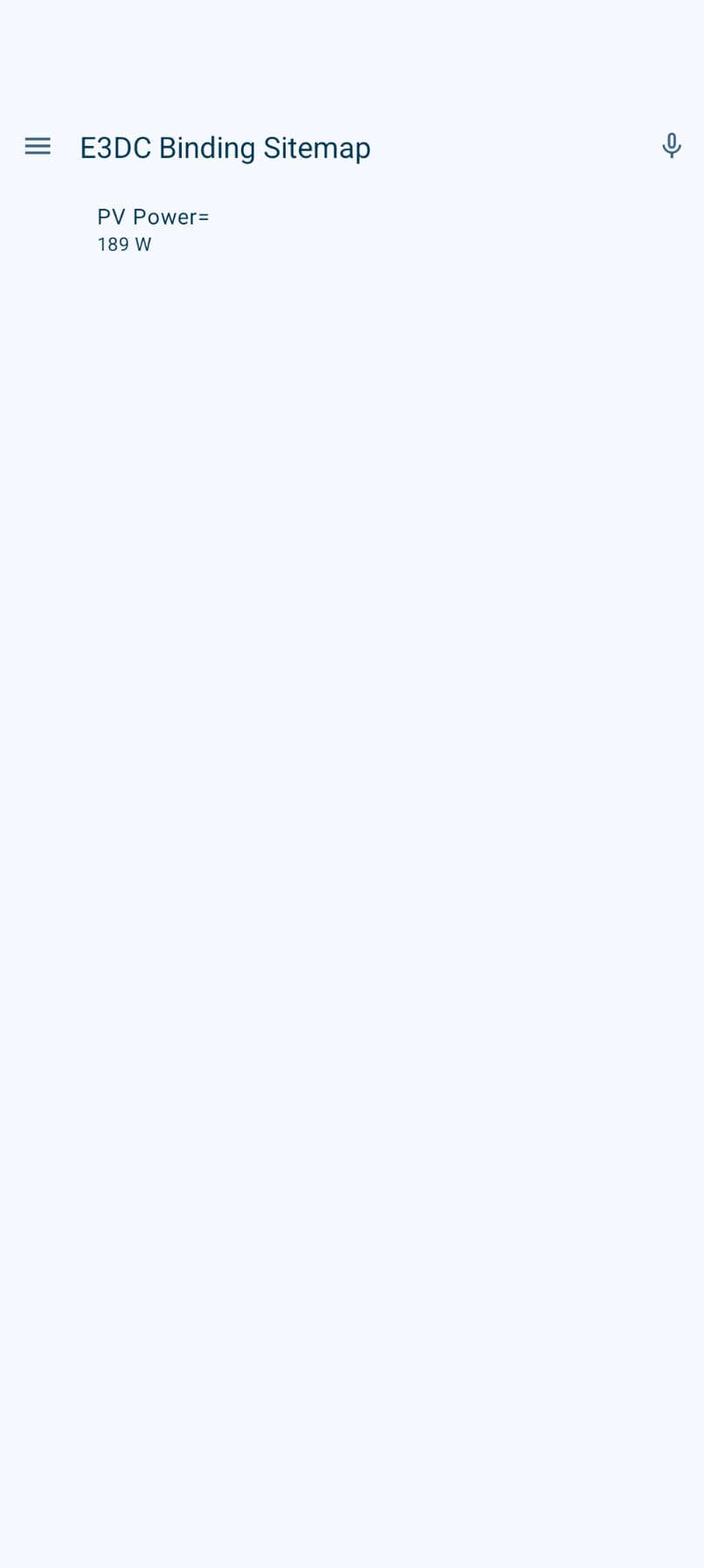

Correct I am using the app on a pixel phone. I tried your solution but then the number is at the left and the label at the right.
Is there not a way just to put the number next to the label like: PV Power=500W
