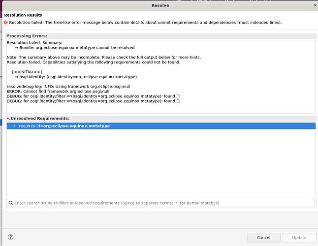

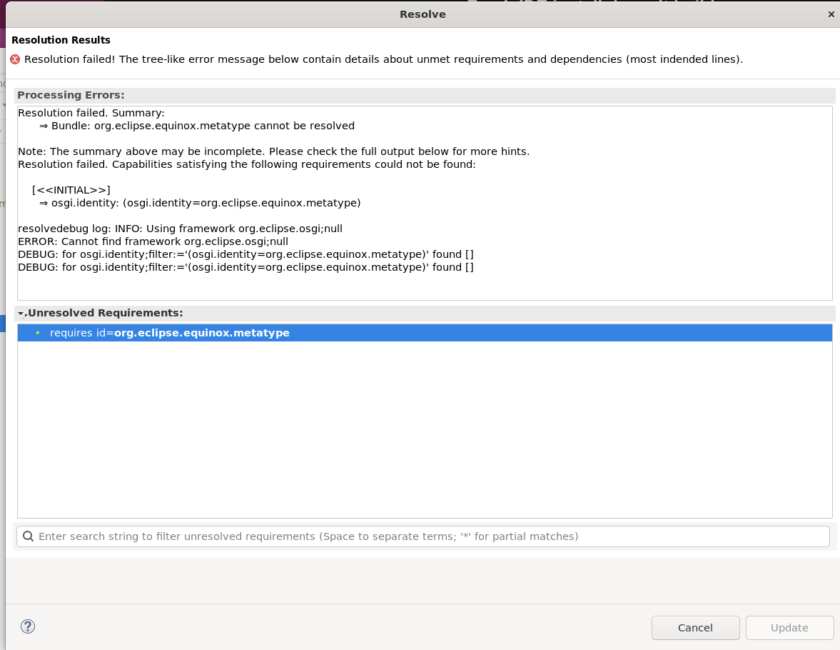

I am running into a similar issue. Did a complete fresh install of eclipse and all associated directories. Even installed the snapshot version of BND (JFrog) instead of the 7.1.x version that does not work.
However, I’m stuck at the following error now when trying to resolve the dependencies:
What am I doing wrong?

Did all the steps, it still does not work. I still get the same error. Any other ideas?
