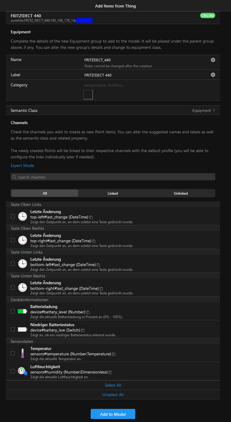

- the error “Bad Request” appears when adding the item

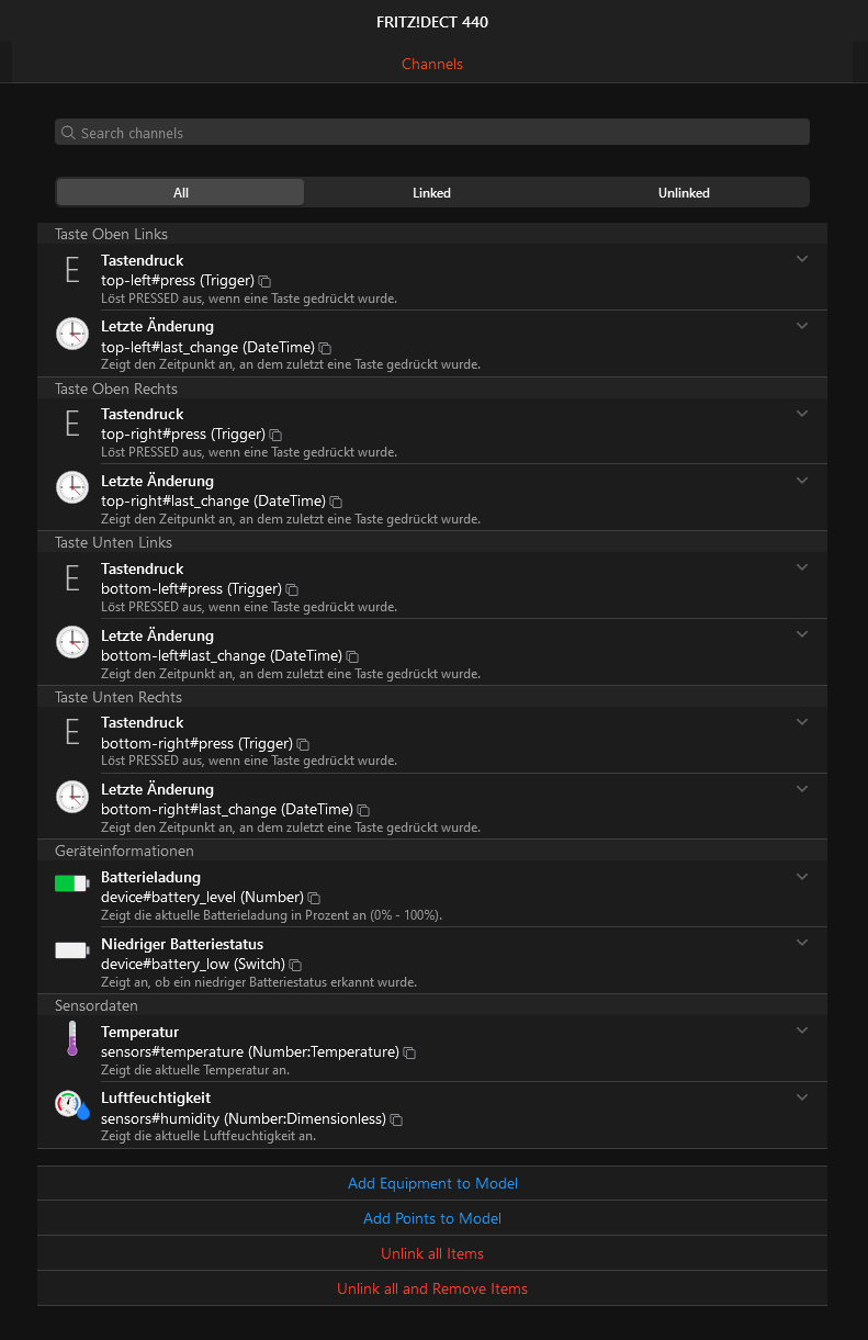

When automatically creating and naming the individual channels, the channel “PRESS” is missing for the buttons.
If I add each individual channel manually, PRESS is available there.
if no button is configured via the FritzBox, openHAB does not seem to receive anything via the PRESS channel either.
Unless I have made a mistake up to this point, it is apparently not possible to control things with the remote control via openHAB itself that cannot be controlled via the FritzBox.

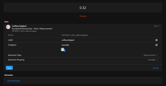

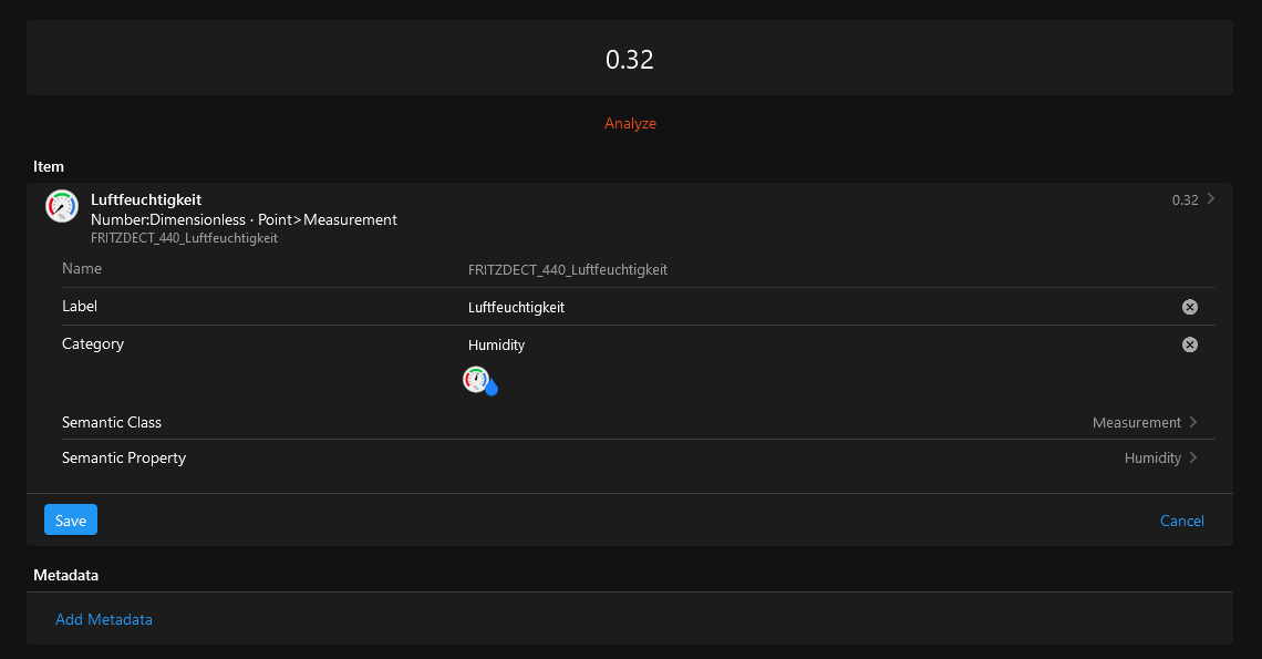

the humidity channel is not set correctly.
For example, 32% is measured according to the button, but openHAB apparently only receives the value “0 one”.
However, the channel for the temperature works without any problems.
After I added the button 6 times to test errors 1 and 2, it seems to have finally worked and the percentage value is output.
