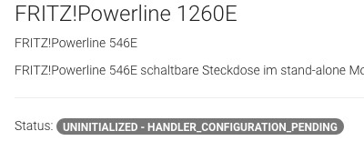

Password set in the configration, status now as follows
grafik
and

One additional information, in the event.log I see the following message now:
'avmfritz:FRITZ_Powerline_546E_Solo:192_168_2_102' changed from OFFLINE (CONFIGURATION_ERROR): User null has no access
