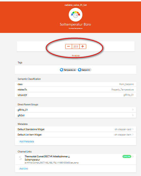

My item in OH3 now has the following syntax:
Number:Temperature radiator_valve_01_Set  "Solltemperatur Büro[%.1f %unit%]" <heating1> (gRFritz_01,gRtSoll)  ["Setpoint","Temperature"]  { channel="avmfritz:Comet_DECT:192_168_178_1:119601003400:set_temp",listWidget="oh-stepper-item" [step=0.5, min=6, max=24], widget="oh-stepper-card" [step=0.5, min=6, max=24]}
and is shown in the items-settings like this:

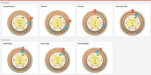

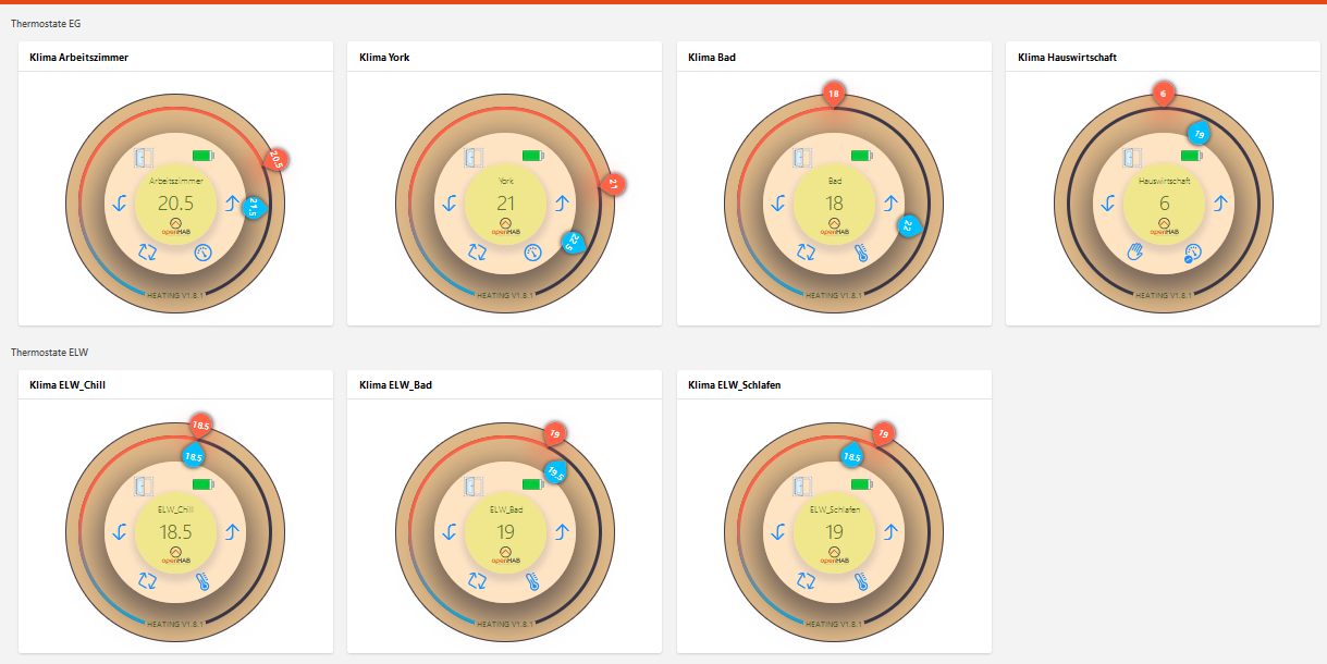

But there are a lot of Custom Widgets here in the Forum and in the Community-Market-Place. The one I use is from @Nico_R . You can find information for the Valve here.
I’m using the widget for temperature-monitoring (it’s not the latest release)
