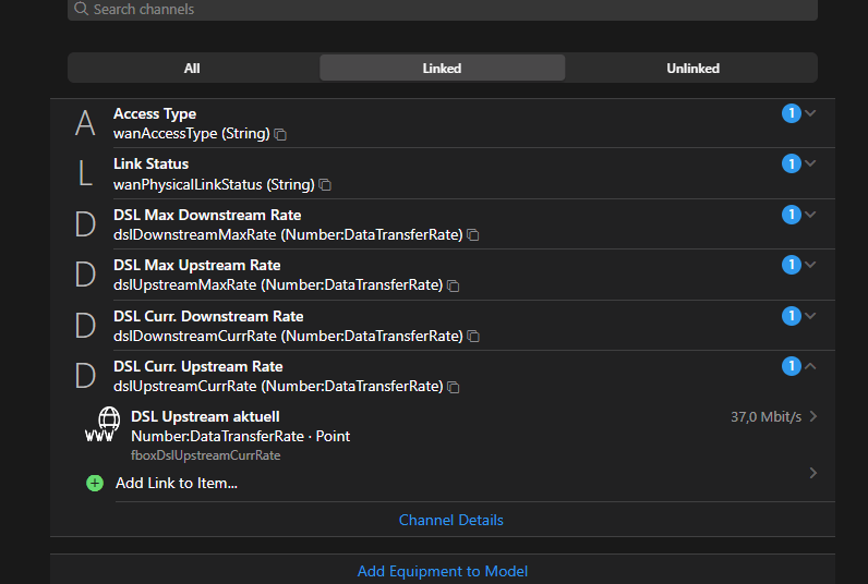

I don’t know if this will help you. For me, it works via the TR-064 binding. However, I also have DSL and no cable modem. The channel (only for DSL?) can be found in the WAN device.
You can still try to get something useful from this channel.

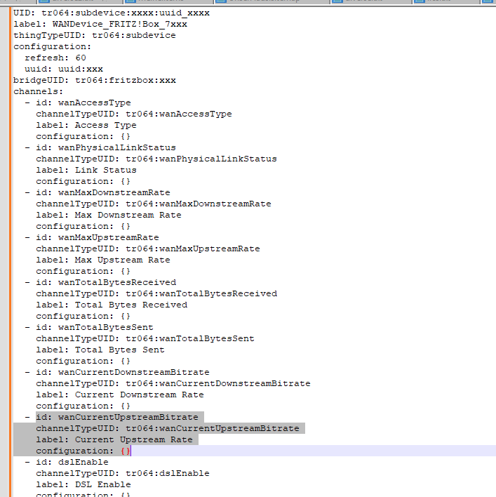

Thanks for the screenshot might it be possible that can you show me the yaml configuration of this channel?
This one?
That’s from the entire WAN device.
Yes, especially I am interested in the channel state description and unit…
