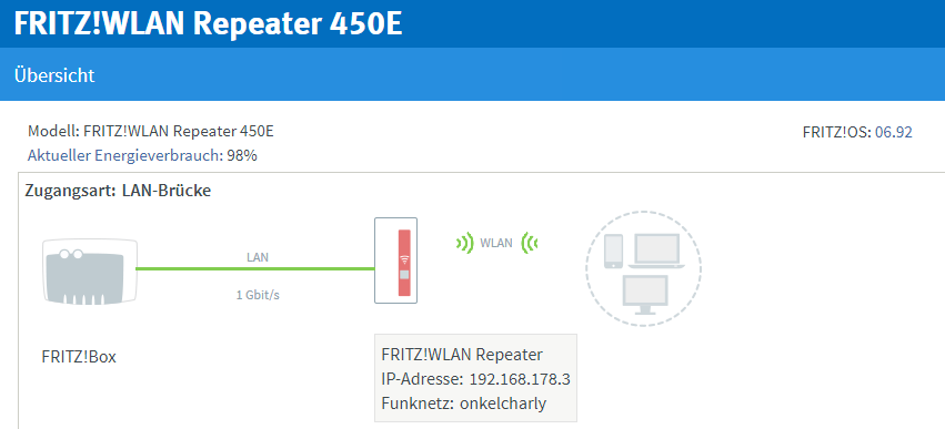

I have the following home network running:
-Fritz!Box Fon WLAN 7390
-Fritz!WLAN Repeater 300E
-Fritz!WLAN Repeater 450E
All the devices share the same SSID, installed on different locations over my house.
I am using the Fritz LAN Bridge mode:
