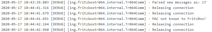

The log says MAC not known to FritzBox!
It sounds like you used the wrong MAC address.
Please double check the address you used in your item and the one that´s displayed in the FritzBox UI.
Yes, I see the log entry, however, the MAC is definitely correct and also listed as Online in the FritzBox’s WebUI. The only difference is that on the WebUI it’s listed with the normal “:” as separators and I have used “-” separators as required by the binding. Otherwise it’s identical.
