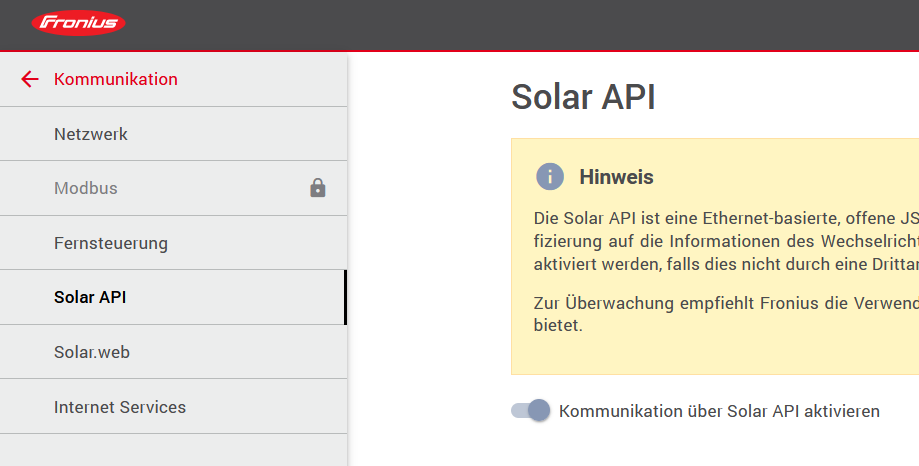

Login to your GEN24 locally and check in “Communication” … “Solar Api” if the Api is enabled.

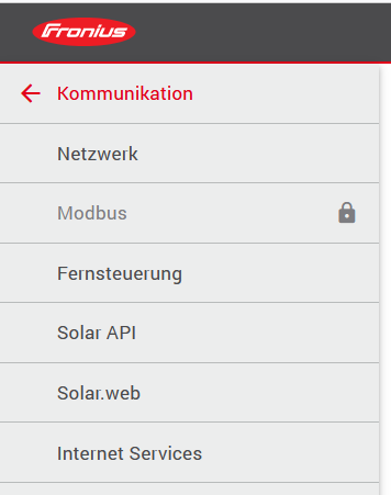

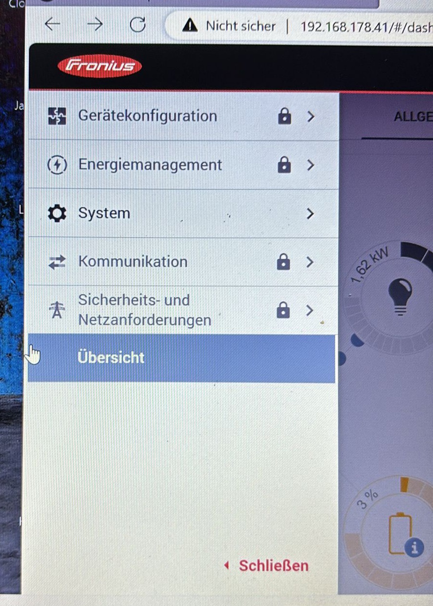

Thank you for the hint. We found the settings->communication menu, however its locked by a password and my friend is missing the password. To make sure we are talking about the same, here is a screenshot of the menu
Can you confirm that this is the right one? Than he will check for the password
Yes:
Default password is 12345678 , but this usually gets changed during setup of the solar system. What you need is the Customer password (Kundenpasswort), which should have been provided by your vendor. There is also a Technician password which mostly you won’t get from your vendor.
