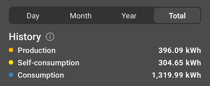

Here’s a screenshot from the app:
according to your post inverterdatachanneltotal + fronius:meter:mybridge:mymeter:energyrealsumconsumed - fronius:meter:mybridge:mymeter:energyrealsumproduced should equal household consuption, right?
but 385.21 kWh + 101.58 kWh - 93.52 kWh = 393,27 kWh whereas the app tells me consumption was 1319.99 kWh ?
What am i missing?
and which values should i use to replicate this info from the app?
the last one (“to grid”) is the value from fronius:meter:mybridge:mymeter:powerrealsum
first value shoud be fronius:powerinverter:mybridge:myinverter:powerflowchannelppv (same as fronius:meter:mybridge:mymeter:powerrealsum ?)
last one should be fronius:powerinverter:mybridge:myinverter:powerflowchannelpgrid
but is there also a channel for the 2nd value (total consumption)? or is this just the difference between the 2 (given) values?
