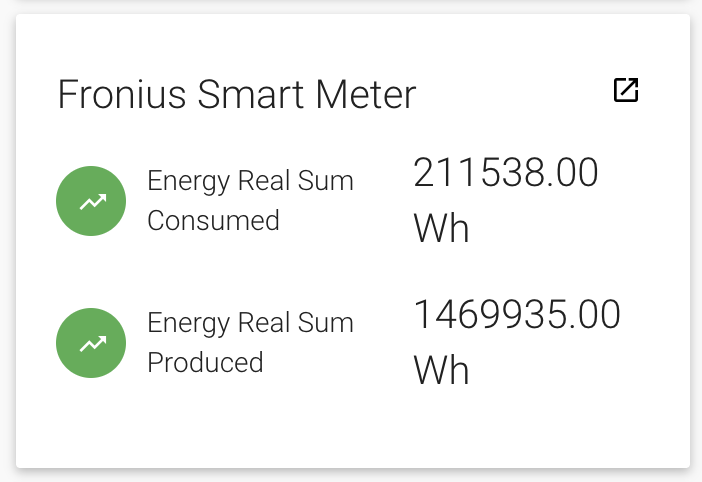

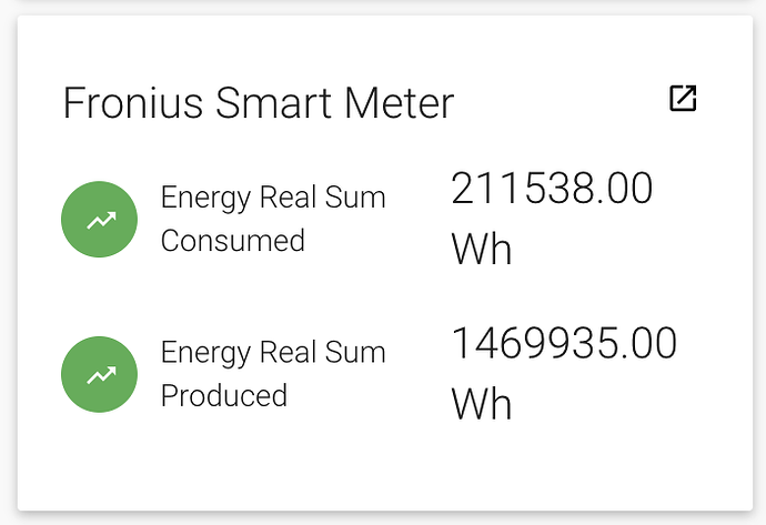

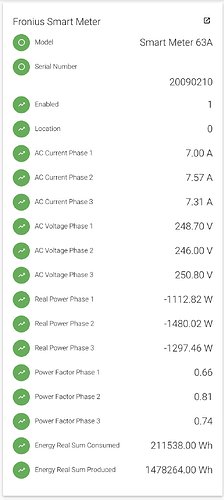

So here’s the thing/items as shown in PaperUI:
So “Energy real sum consumed” is just the total grid import that we pay for, and the “Energy real sum produced” is the total grid export.
The total household energy consumption would be calculated from “Energy generated overall” (the inverterdatachanneltotal channel from the inverter) plus “energy real sum consumed” minus “energy real sum produced” - assuming that the meter is installed on the grid side.
To calculate the daily usage, one must take a snapshot of the values daily, subtracted from the previous day’s snapshot. This could probably be done using cron + persistence, I have yet to write the rule.

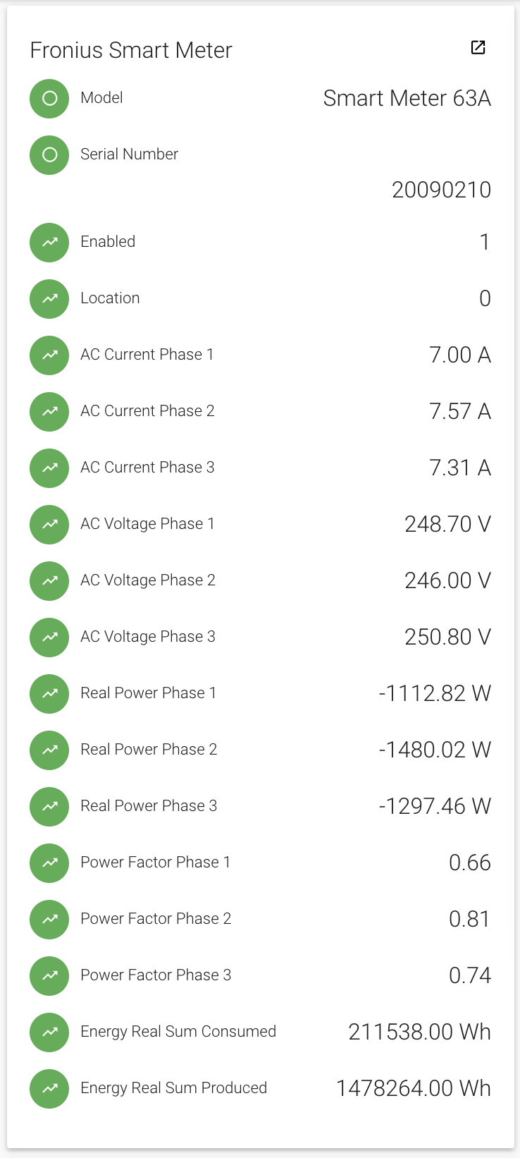

I’ve added more channels / data to the meter thing:

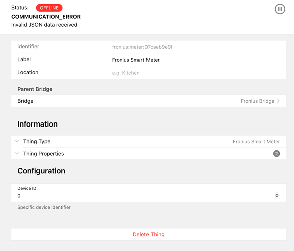

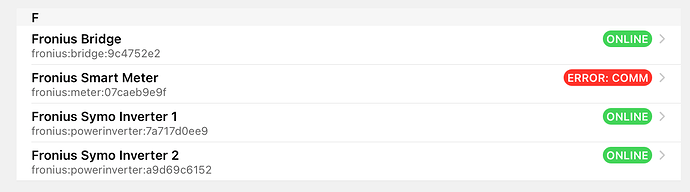

in the ui it says…
COMMUNICATION_ERROR
Invalid JSON data received
if I change the device id to anything other than 0 it gives the same error’s in the logs but in the ui it says…
COMMUNICATION_ERROR
Meter 1 does not exist
My meter model is a Smart Meter 63A-1 if that helps.

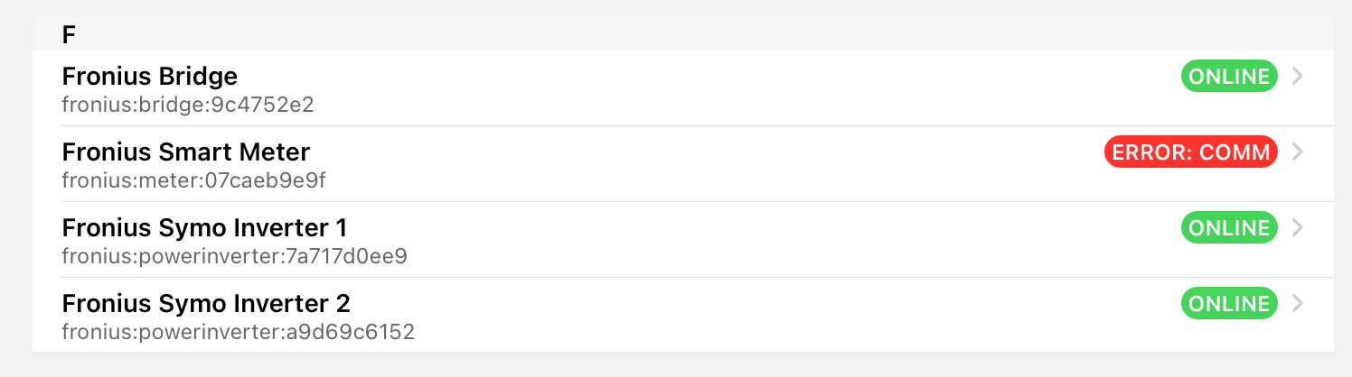

Yea its weird, the bridge and both inverters are showing as online and im getting info from the channels.
Do you have any more ideas as to what to try next?

Thanks. I understand the problem now. The binding was tested with a 3 phase system. I’ll have to make some changes to support a 1 phase system as well. For the time being, this won’t work for you. I’ll post an update here to let you know when it has been updated, probably in a day or two.
