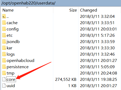

Hi @rlkoshak, thanks for the tuts, a non cache/tmp question, what is core file? This file located in /userdata root with about 274,552KB size(2.3snapshot #1225), can I also need to delete this core file when upgrading?
add1: I’ve deleted this core file and it seems nothing happen, system still running well, so I am confused, what exactly does this core file do and why so large? Thanks

A core file occurs when a program crashes hard work a segfault. I’m surprised to see one here. It is late because it contains everything in ram at the time of the segfault. Had OH ever just inexplicably stopped?

Nope, this is a brand new docker pull today, I never happen to see this core file ever, I docker pull the same image on rpi3,2,1 and x86 vm machine, never get that core file thing, and I think OH never accidently stop.
although there is one thing maybe related to this core file, is because I use a brand new sbc called NanoPi Duo to setup this openhab server(screenshot from that server), everything running so good but memory usage is go very high(435 of 512ram + 64 of 621zram, also running 10 containers in background, grafana,influx,mqtt,etc..), not sure if this is causing the core file thing created due to low mem..
so far so good still…
